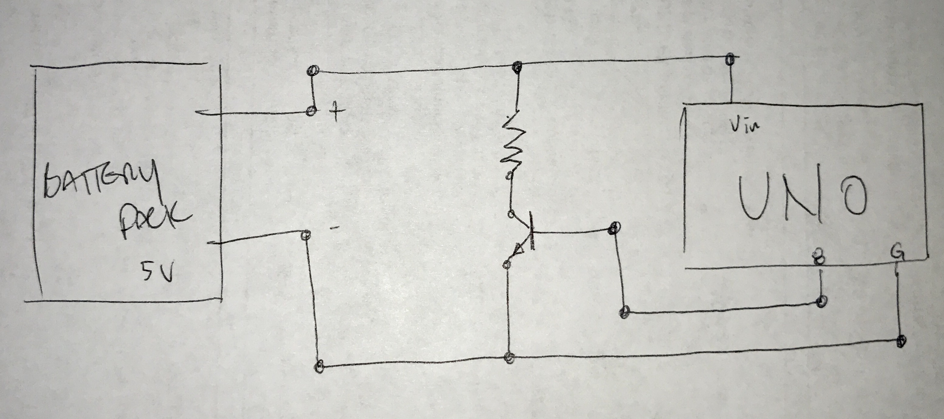

If your power pack is a backup cell phone charger, it will switch off when the current falls below a certain level, it thinks the phone is full charged and won't overcharge it, try a 1/2 watt 100 Ohm resistor across the + and - rails and see if it stays on.
You may have to go as low as 27 - 33 Ohms but watch the resistor wattage, may need a 1 watt.
Ok, I just happened to take apart a UPS power unit from Tripplite and just happened to find a 47Ω resistor in there. So I plopped it on a breadboard and it works, the battery doesnt standby anymore. So why does this happen?
When the phone is fully charged, no current is drawn from the charger, so it shuts down. A fully phone charged presents a large resistance which tells the charger not to push anymore energy out so it shuts down?
And then when we put the 47Ω resistor bridge between the -/+ charger terminals, it suddenly only has a small 47Ω resistance, so it starts pushing out current?
Your assumptions are pretty much correct, problem with your fix is the resistor constantly wastes 530 mW, I wrote a simple sketch to pulse the resistor periodically to keep the power bank from timing out, I found that a 50 mS pulse through a 56 Ohm resistor every 15 seconds would keep mine alive:

You can try different length interval and pulse to find a minimum that will keep yours alive.

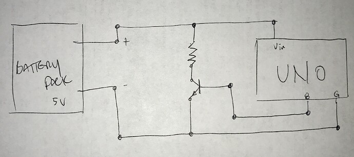

You mean like this:
Yes, but the 5V goes to the 5V pin, the VIN pin needs at least 7V to produce a 5V output. Don't try to drive more than about 750 mA into the 5V pin, the circuit board traces might overheat. Also, be cautious when plugging in a USB cable, if the power pack voltage is too high it may feed back into your PC and damage it, make sure the power pack voltage is well regulated 5V.
The voltage from the battery pack is 5V. I always forget the differences between the 5v pin, the Vin, the barrel jack and the usb jack. Ill read up on that again.

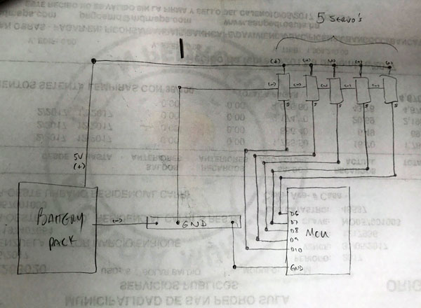

As for the current draw, right now the project is just a MG995R servo and an LCD. But in the future the project is supposed to grow to an MCU with its LCD running 4 to 8 servos, not simultaneously though. Servo1 would run for 1 minute and stop, a couple of minutes later Servo2, and so on. So it would not be drawing current for all at the same time. But if I wanted to eventually connect 3 servos that would run simultaneously and I know now that I cant pull more than 750mA from pin 5V, I would set it up to run the servos separately from the mcu.

Your drawing looks fine to me but you need a VCC (5V) wire if not powering from USB.

Marciokoko:
You mean like this:
No, not actually like that, like the circuit given in #3, the one with the required base resistor....
Oh thanks! Forgot the base resistor.

The connections are as were suggested. Im using D7 off the nano to send a pulse through a resistor to a 2n2222 transistor, out to GND and 5V from the battery:
