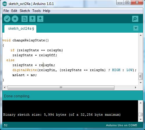

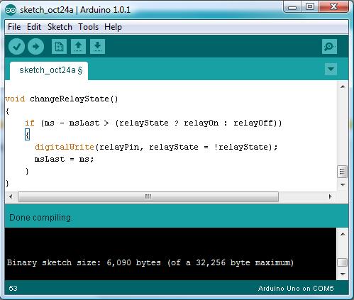

Hi Nick. All I did was substitute your recommended code change into my changeRelayState and the relay wouldn't come on afterwards. I put original code back and it comes on. As you are probably aware I am new to all this. So please go easy on me.
Original Code
void changeRelayState()
    if (ms - msLast > (relayState ? relayOn : relayOff))
      digitalWrite(relayPin, relayState = !relayState);
      msLast = ms;
New Code
    if (relayState == relayOn)
     relayState = relayOff;
     relayState = relayOn;
     digitalWrite(relayPin, (relayState == relayOn) ? HIGH : LOW);
     msLast = ms;
We are missing a brace here. Can you post the code that actually compiles please?
I took one out.
They both compile fine on my system. See attached images.
What Nick is asking is that you post (in it's entireity) the latest sketch that you're having problems with. It's too hard to help if we're guessing what you changed.
Ok. Sorry.
The comments on the #define statements indicate that relayOn and relayOff are times, not states. So, comparing relayState to relayOn or relayOff doesn't make a lot of sense.
