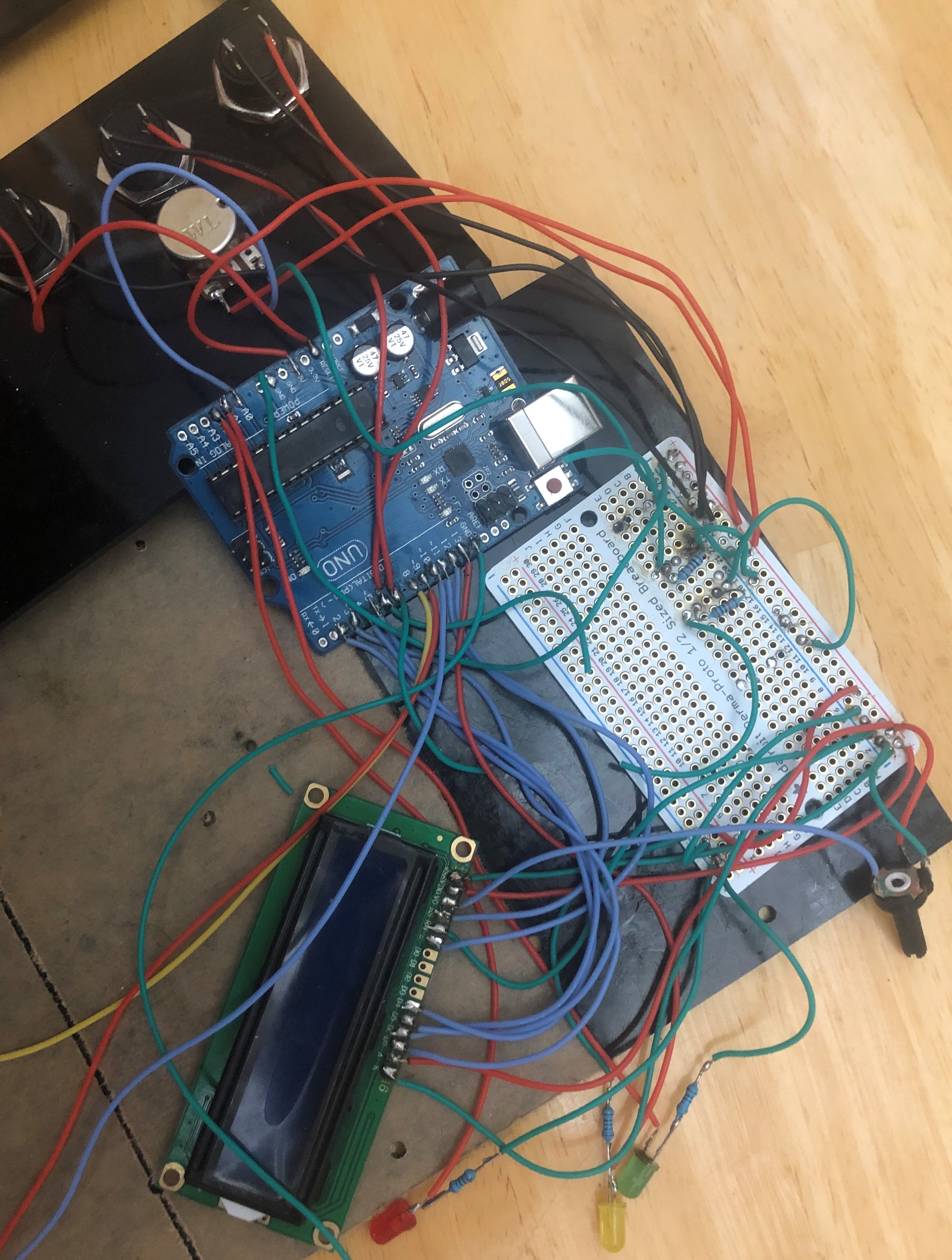

Start/Stop DC Motor Control Using Momentary Button and LCD. Help Please

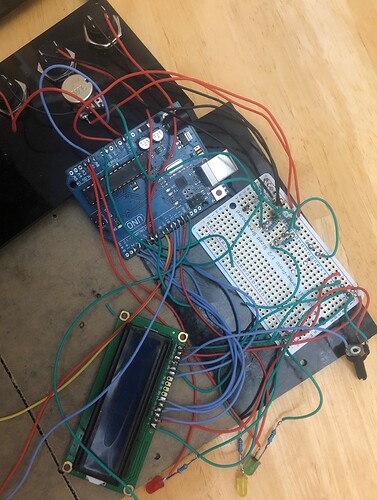

Here is another view
Do you know what would cause the LCD contrast to fade over time once the program has been running for a bit?
Sorry, your soldering needs to be improved :confused: .
Clean solder connections with a Q-TIP and some Isopropyl Alcohol
You may have a bad LCD display, try a new display.
Suggest you use stranded #24AWG wires as solid wires can easily break.
I wont argue with you there! :slight_smile: I machined all the parts for this machine perfectly and then had figure out how to make it move! Thank you! I really appreciate all of your help and you got me to the point of a working machine. I will continue to learn and hopefully my next project goes a little smoother! Thanks again
