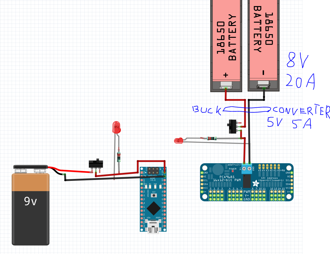

Update after almost 2 months.
I'm at the finish of the project.
In terms of power supply I use 2x 18650 batteries which gives me around 8V. I got this buck converter which is set for 5V 5A output.
I have a question concerning the two LED Diodes. I have 2 toggle switches:
-one for 9V power battery which's going to power arduino (i'm going to connect 9v battery to the VIN pin)
-one for the power supply of the servos
I want the led to indicate if the switch is switched on. Will this schematic work?
I'm afraid of the high current on the right side.
What resistors should I use? How can I manage to do that?
