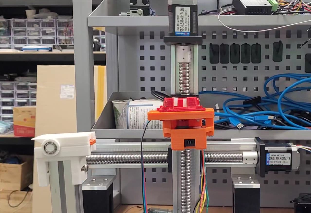

operating mechanism :
void Left_To_Grasping_Position();
x axis : 20mm downward
z axis : 20mm leftward
void Left_Pickup();
x axis : leftward
z axis : upward
void Left_Turn();
x axis : rightward
z axis : downward
void Left_Escape();
x axis : 20mm rightward
z axis : 10mm downward
** problem:
motor direction does not change.
  • in pickup stage, z axis motor continuously move downward.
  • in turn stage, x axis motor continuously move leftward.

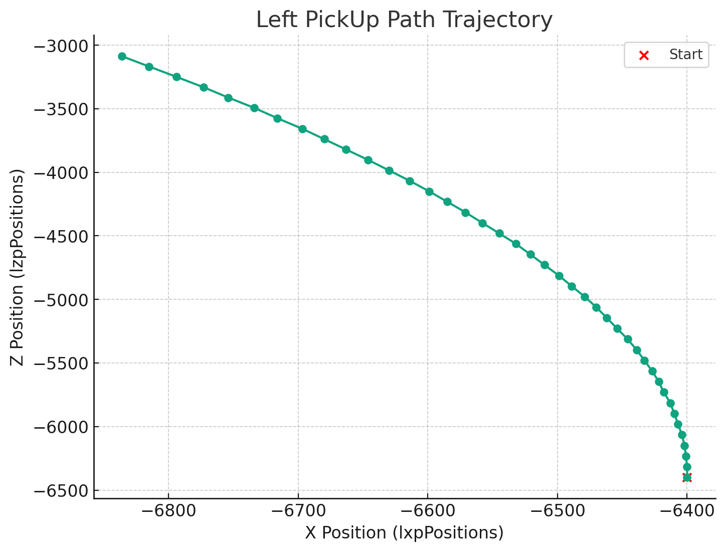

  for (int i=0;i<N+1;i++)   //Generate Left PickUp Path
    lxpPositions[i] = INI_XPOSITION*1600/5 -1*round(1600/5*(PR-PR*cos(2*PI/360*15/N*i)));
    lzpPositions[i] = INI_ZPOSITION*1600/5 +1*round(1600/5*PR*sin(2*PI/360*15/N*i));
    lgpPositions[i] = INI_GPOSITION - 1*round(3200/360*15/N*i);

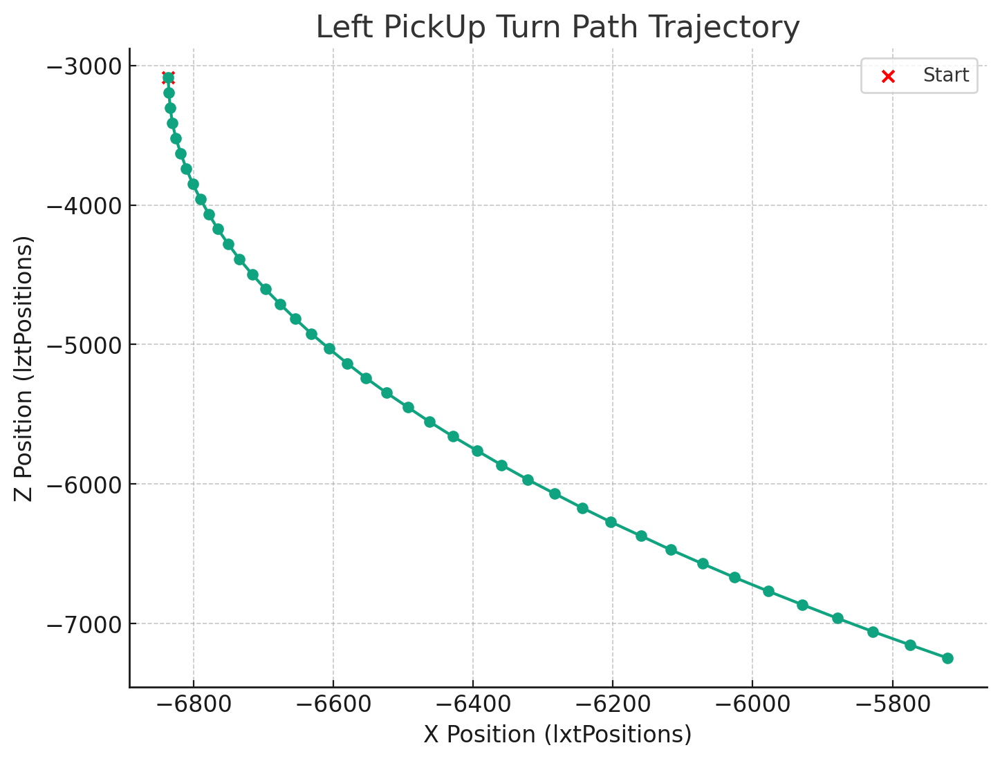

  for (int i=0;i<N+1;i++)   //Generate Left PickUp Turn Path
    lxtPositions[i] = lxpPositions[N]+1*round(1600/5*(PR2-PR2*cos(2*PI/360*30/N*i)));
    lztPositions[i] = lzpPositions[N]-1*round(1600/5*(PR2)*sin(2*PI/360*30/N*i));
    lgtPositions[i] = lgpPositions[N] + 1*round(3200/360*32/N*i);

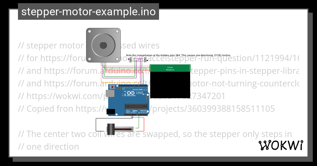

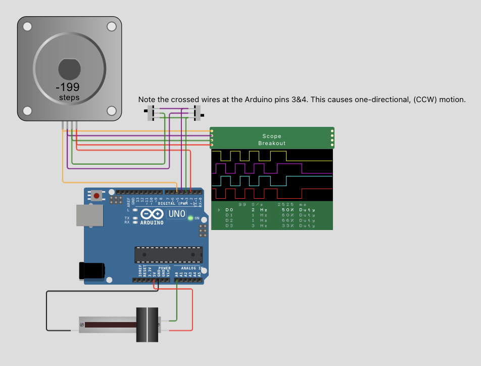

Check the wiring of your steppers coils vs the coil connections on your drivers--if the coils are crossed, the steppers move in one direction:
(Wokwi updated to add switches, wire colors, defaults, and to slow things down)

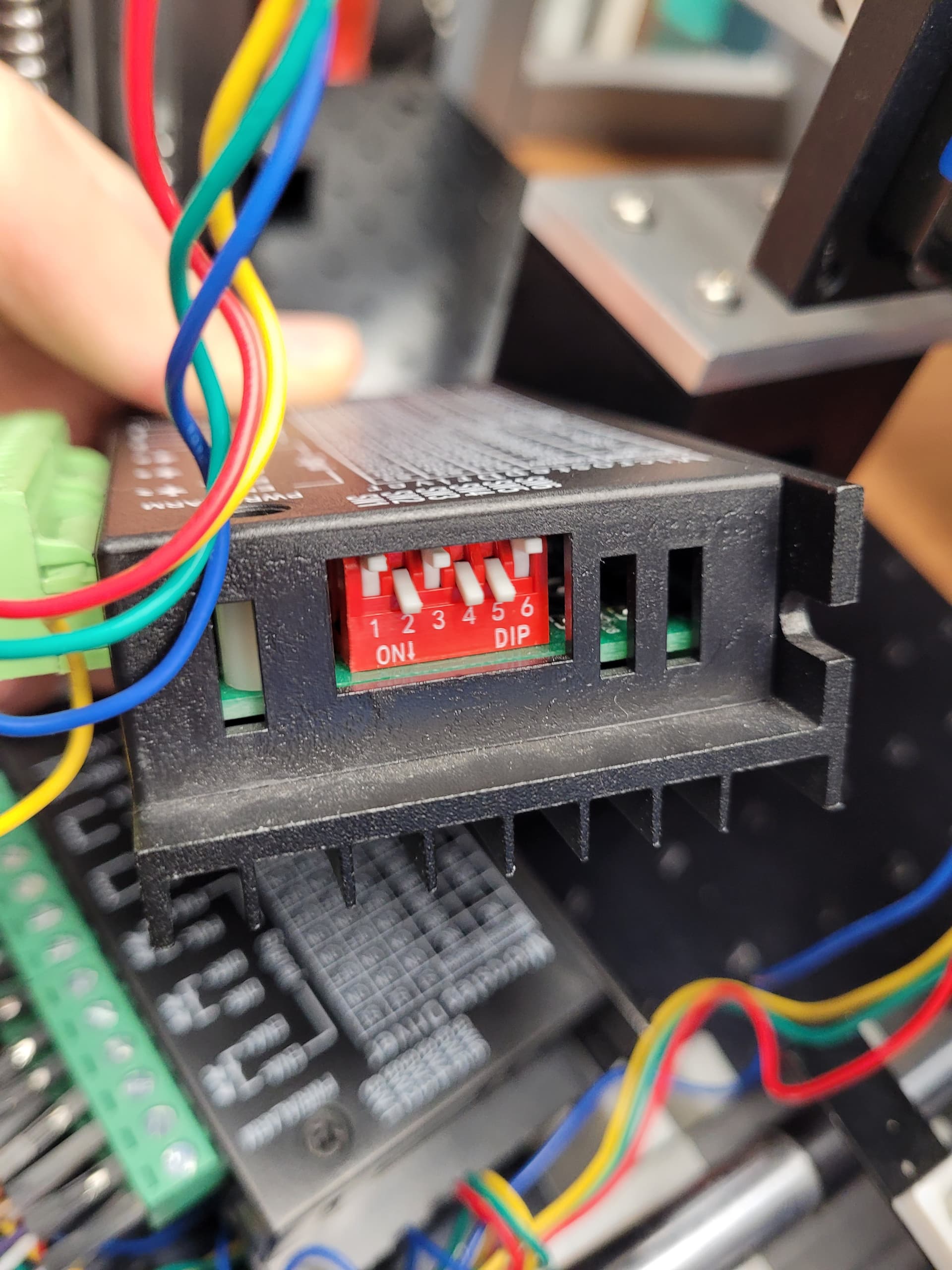

The problem was the attached motor driver "SBD-10".
I used TB6600 motor driver instead of using that, it works fine.
but still 0.1A LOL

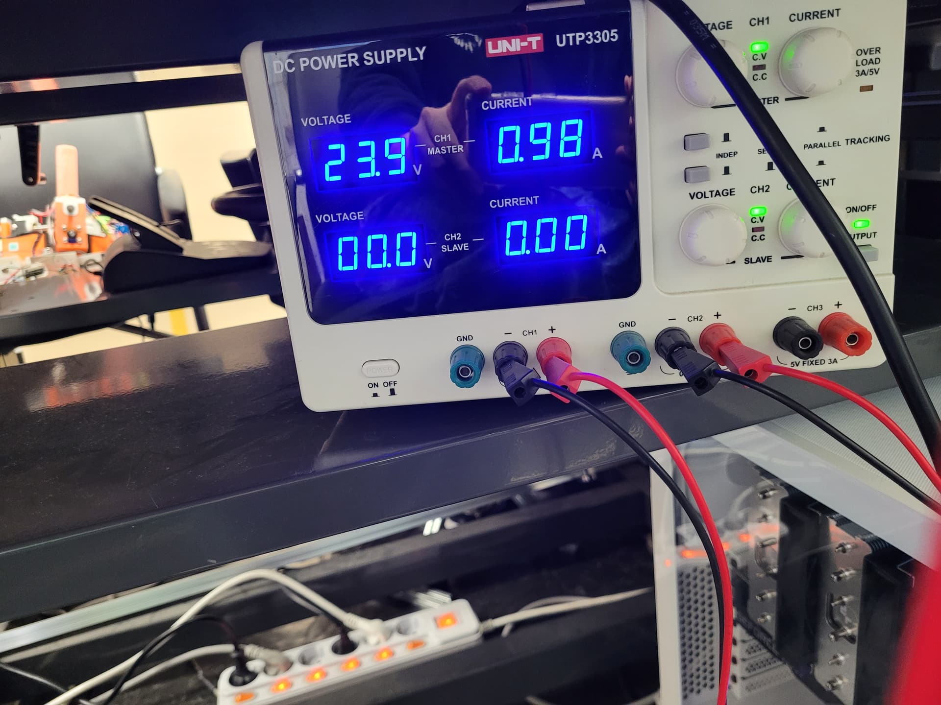

Where did you set/measure this.
The TB6600 has no setting for 0.1A. How did you set the current at the TB6600?
I just checked. I set current for 1.5A and peak current for 1.7A.

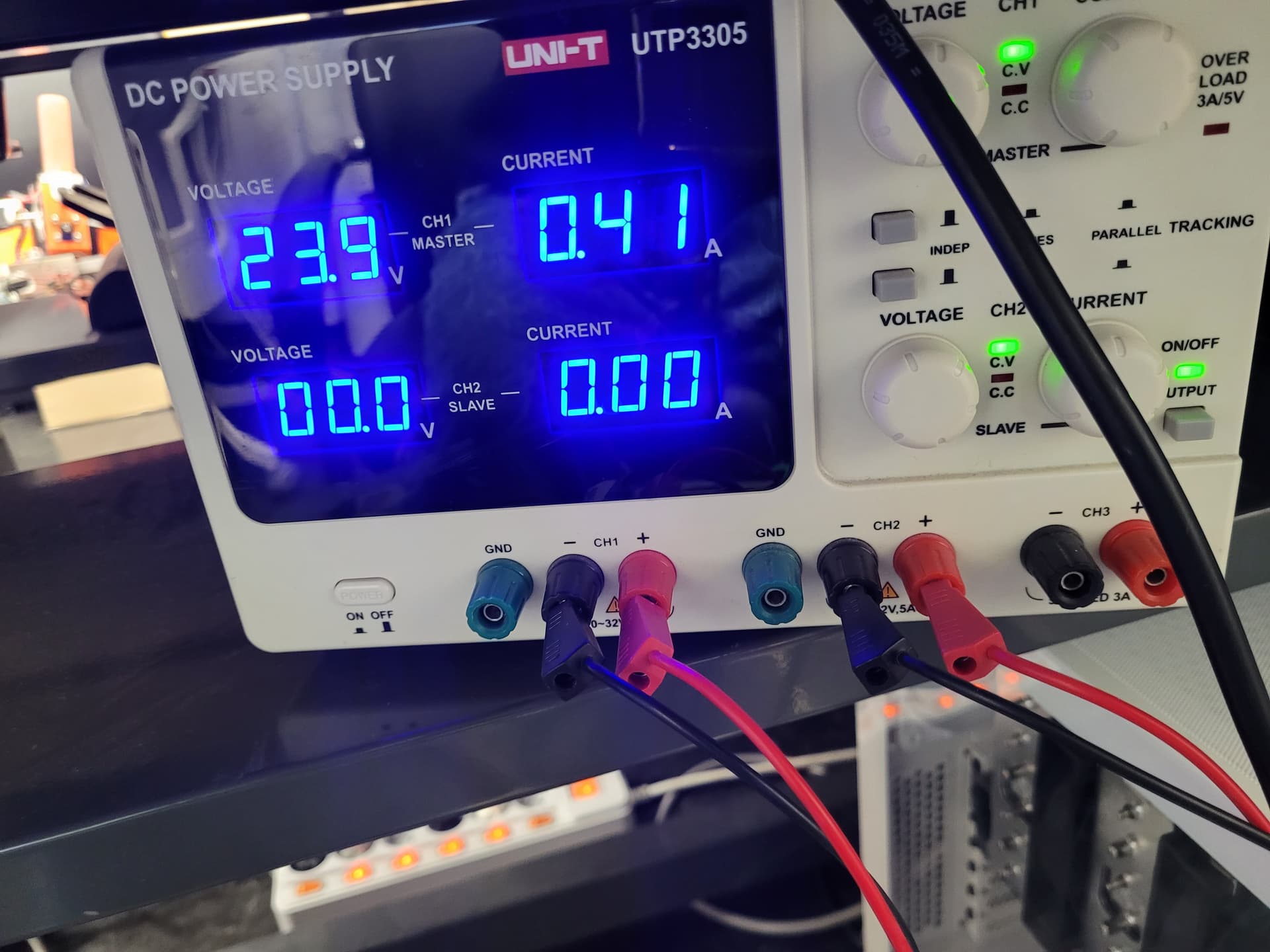

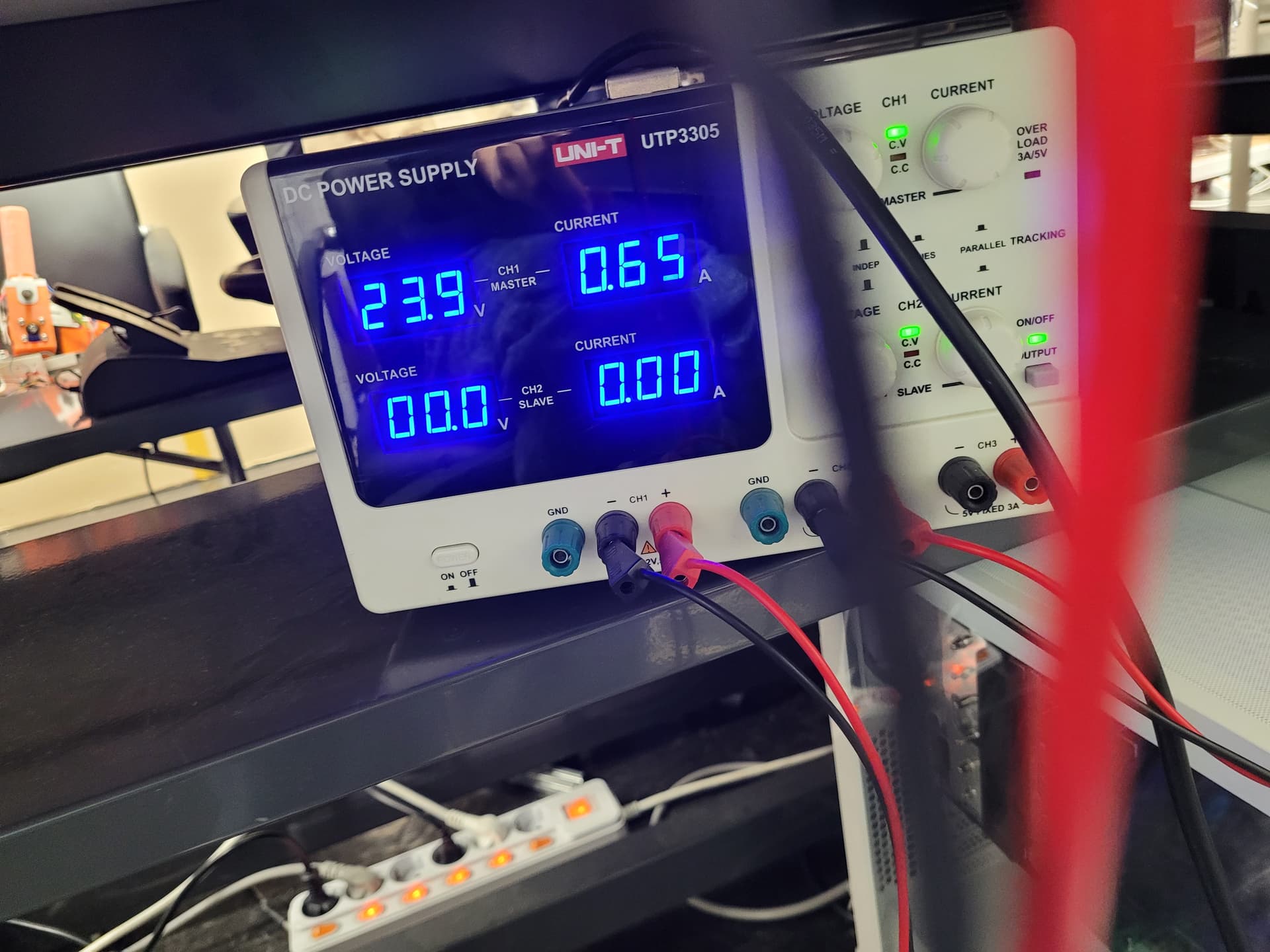

when i turn on the power supply, current is about 0.4A.
And it changes between 0.4~1A.
It works fine but I wonder why is different between set current(1.5A) and measured current(0.4~1A)?
This is the setting for the coil current ( per coil!).
These current controlling stepper drivers ( like the TB6600 ) work similary to a ( short-circuited / current limiting ) step down converter. So the higher the voltage from the PSU, the lower the current from the PSU.
You must consider the power needed by the motor coils to select a proper PSU ( and interpret the measured current correctly )
