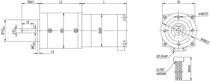

You can get geared steppers with a 3.6 : 1 (18 : 5) ratio, 1.8 degrees in = 0.5 degrees out.
I can't attest to cost & quality. :confused:
GM42BYGH416-G3.6
