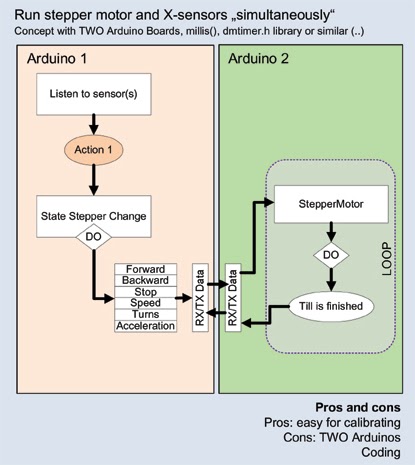

How to run a stepper motor with different sensors simultaneously. I try to show you two little concepts. Of course using dmtimer.h library or similar like millis() (..).
It's easier to make two graphics - enjoy.
@All - if you have some other ideas, please tell.
Concept 1 - run stepper motor and X-sensors „simultaneously“
ONE Arduino Board, millis(), dmtimer.h library or similar (..)
Pros and cons
  • Pros: one Arduino only
  • Cons: difficult for "calibrating stuff"
Concept 2
With TWO Arduino Boards, millis(), dmtimer.h library or similar (..)
Pros and cons
  • Pros: easy for calibrating
  • Cons: TWO Arduinos and coding overhead
graffeli:
You don't seem to have considered reading the sensor between steps?
...R
@Robin2 - yes, exactly. In concept 1, "reading the sensor between steps(..)" is not possible, because an arduino system is not a multitasking/multithreading system.
As user «designo» has described, pending reading/using a sensor in the loop section in ArduSketch, the response of sensor can be (or is) too long and the "motor/s make a «clack» (..)" - the motor has a millisecond coughing/interrupt.
graffeli:
I agree it just has a single CPU, but you can certainly write code to do other things between steps - unless, of course, you ned a very high step rate.
You don't sit patiently in front of the oven while you wait for a chicken to cook :slight_smile:
I have a program that controls 3 stepper motors for a small CNC lathe. If it could not do work between steps how could motors 2 and 3 move?
...R
