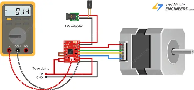

i was using driver A4988 when using it the stepper motor(neema 17) was not turning with no vibration and also when checking the current with multimeter it was 120 mA and on the another driver it was zero mA between motor and driver but there was severe heating . Are there any suggestion on how to check whether it was working or not .. or am i doing anything wrong ?

this is the website i referred
it worked fine at first
i checked the rating in the datasheet then connected the driver to stepper motor and driver to arduino nano board where logic 5 volt is given to step, dir , Vdd .
at first checked the current from driver to motor then adjusted the potentiometer to the rated value.

Referring to picture in post #10, if you switched the meter range while the driver was powered, you may have ruined the A4988.
i just changed the meter while it was powered up
that was cause of ruin

Please state how you set the A4988 current limit to 1 Ampere or less.
Please post a photo of the setup, showing the connections between the motor, motor power supply and the driver.
i have posted above refer post 9
Did you set the pot so the meter read 1.00 Amps? That should be done with the motor disconnected and voltage read at the Vref test point.
i did it without disconnecting is that where the damage occured ?
