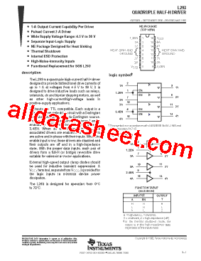

ok, jremington is right if he says that you need a stepper motor-driver. but you dont need the ones he has shown you in his link.
a simple L293DNE should work fine, as described here:
hope this could help?!?
cu
The L293 devices are poor choices for driving stepper motors.
"Proper" stepper motor drivers just need 2 connections to the Arduino - step and direction - which makes them very easy to program. And they usually have the ability to limit the current in the motor coils so that you can drive the motor with a much higher voltage for better performance. And they can usually have the inbuilt ability to do microstepping if you need more precision.
Even if I didn't need the extra performance I would choose a proper stepper drive just for the convenience.

since i am new to arduino and motors and things like that: can someone explain the difference between the l293dne as i mentioned and the A4988 or DRV8825 as jremington said?!?
thx for your help!

jn-wp:
The L293 and L298 are h-bridges that are primarily intended for controlling DC motors. They can be used to control the current in the coils of a stepper motor but all the "intelligence" about the order of magnetizing the coils has to be provided by the Arduino. They also need 4 connections to an Arduino. And the motor can only be driven with a voltage that doesn't overload the motor coils.
Proper stepper motor drivers like the A4988 only require two connections to the Arduino - step and direction - and the driver does all the complicated stuff to energize the coils in the right order. The proper drivers are usually also able to drive the motor with microsteps for greater precision - a 200 step motor could be driven with 3200 steps per revolution without any extra "intelligence" needed in the Arduino. Another very valuable feature of proper stepper drivers is the ability to measure and limit the max current in the motor coils. This allows a motor to be driven with a high voltage (30v or so) which allows it to maintain its torque at higher speeds.
