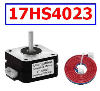

I have recently created a cool custom board that supports 8 stepper motors for a precise robot implementation I have been working on for quite a while. Today I wired it up correctly and it worked, but now I messed it up, and it has been jittering since.
I looked at all sorts of online documentation, and I just find the premise of these stepper motors confusing.
Now I believe the source of this issue is the pinout, as I got my motor to work with the custom board, messed it up, moved it to bread board, and still find issue with it.
Does anyone know a quick, convenient way to identify poles and maintain them? Any assistance much appreciated.

The usual pairings for those colors are coil 1 (black, green) coil 2 (red,blue).
I am unable to view the videos, perhaps if you post them to a site without restricted access they could be viewed.
Jittering might be due to motor current limit too low, in which case increase the limit via the trimpot.
Alternatively the current limit may be too high and the driver cycles in and out of thermal shutdown. If the heatsink is very hot, reduce the limit.
The trimpots are quite fiddly to adjust. I use a ceramic screwdriver to avoid accidental shorts.
If the circuit worked, and then stopped working, it may be a broken driver.

All my drives are set to At least .6 in Vref and then some, as to reach the minimum 1.5 Amp draw.
Also, the pinout the of the motor has different wiring all over the place, making it confusing, two different documentations:
Try reducing the step rate.

I will try to also move motor leads around and standardize myself with the motor.
How do they continuity/resistance check with a multimeter? The two coils shouldn't have continuity between them.
