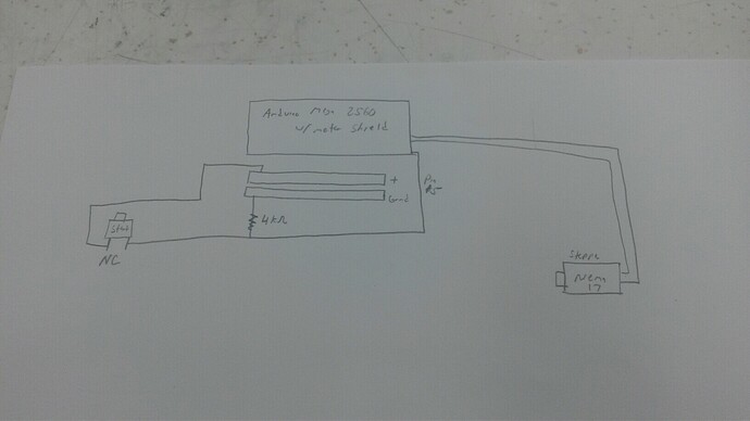

Have you got pullup or pulldown resistors on your switches.
If a switch is open and you do not have an appropriate resistor to pull the input to the opposite logic to the closed switch, the input is floating and can have any value, usually that of the switch closed, even though it is open.
This includes limit switches.
What model arduino are you using?
Tom...... :slight_smile:
if(startState == LOW); // start test function
What were you thinking?

I do have pull-down resistors from one leg of the "on switch" to ground. The same leg is connected to an Arduino input, while the other leg is connected to power.
Note that the switch is normally closed, which is why I have "when start button is low, continue program" line in there. The switch isn't a detent so it's closed until you push it.
I have attached a hand drawing of the circuit that is giving me trouble. There are 3 other switches in the circuit all connected in the same way as the one drawn, but they aren't giving me any trouble.

Hey everybody,
I got the sketch to work! The culprit was the semicolon after the first if statement. For some reason it was skipping the if test. All I did was remove the semicolon and the sketch ran.
Thanks to everybody who replied!
