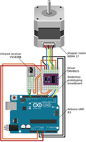

Hello, could anyone assist me with an issue I am having with my stepper motor? I am using an Arduino UNO R3. My stepper motor is supposed to rotate when I press buttons on my IRRemote. It glitches and isn't running. Is there a way that I can get it to run, or can someone please proofread my code? The setup image I followed is attached below, along with my code:

The Arduino is not a power supply, and cannot provide power to motors or servos.
Steppers generally require 12 to 24V at several Amperes, provided by a dedicated motor power supply. You also must adjust the current limit properly on the motor driver.
The DRV8825 requires a minimum of 8.2V to work.
Have you set the coil current limit on the DRV8825. That step is imperative. https://www.circuitist.com/how-to-set-driver-current-a4988-drv8825-tmc2208-tmc2209/

What is the battery supply voltage?

Thank you so much. Adjusting the motor driver current limit is not something I thought of.
OMG the website you linked was super helpful. I'm gonna try that an give you the update
I am using a DC voltage of 12V
This is a good idea, that way I can isolate the problem. I'll do that and let you know. Thank you
Hello everyone, I used a potentiometer to set the reference voltage of my DRV8825 to 0.5V. But the stepper motor still isn't moving, and now whenever I plug it into a power source, the power input in the arduino circuit begins to fry. Also, when I plugged it into the computer to load my code onto it, my motherboard battery fried. Could anyone assist me?
I am using a 12V power source. I have attached a link to the video of what happens when I plug it in.
Do post a proper schematic of your setup.
As mentioned before, an Arduino is not a power supply. Don't use it to power your stepper. Use the 12V supply to power your stepper driver directly instead.
Again, do run a basic sketch that does nothing but running your stepper. Get that to work first.
Please post some images of your project.
Please post your test code that I referred to in post #7, that you write.
Tom.... :grinning: :+1: :coffee: :australia:
