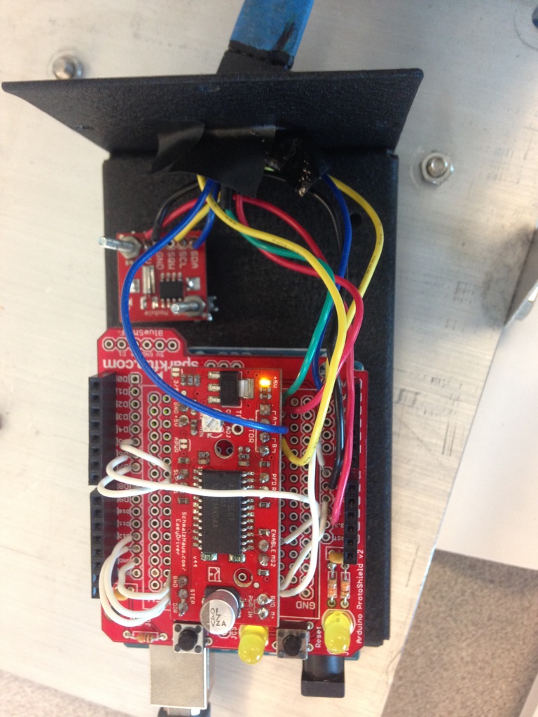

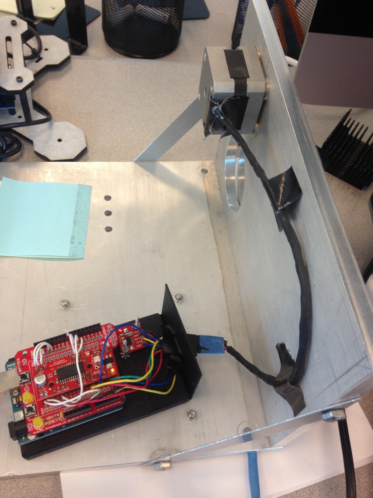

I have attached pictures of the actual set up, drawings still to come. The little grey cord plugs into a Mac mini via USB.
Unfortunately I'm no artist. PLEASE let me know if anything is unclear.
Thank you all again so much.
Are my eyes deceiving me or are your wires just pushed into the holes and not soldered?
They are soldered, underneath the board.

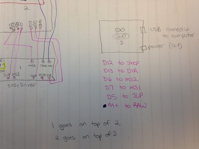

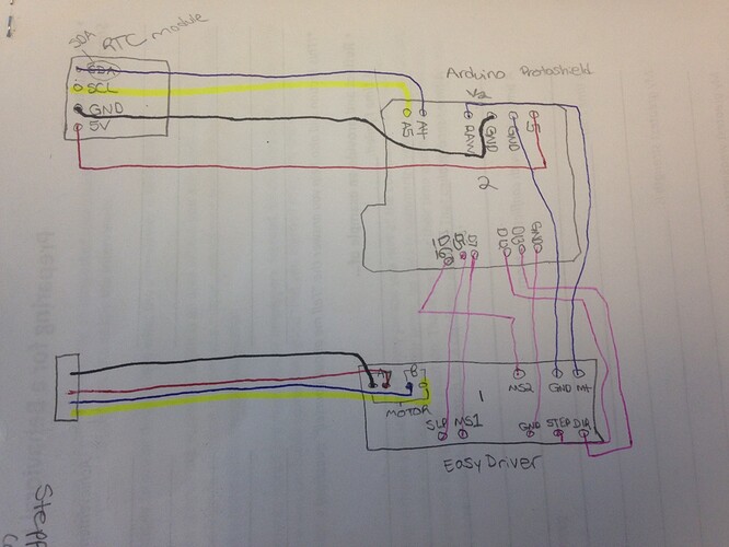

babycoder:
I don't expect artistry.
But your drawings are too cluttered to be able to make sense of them and some of the writing is upside-down.
Don't stack the components in the drawing even if they are stacked in real life.
If the yellow thing is the Easydriver, why is the motor not connected directly to it ?
(By the way I have only looked at the drawings)
...R

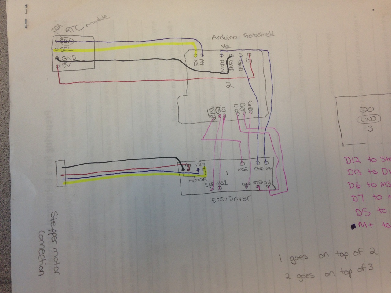

Hi there,
Thanks for the advice, I will redraw the components unstacked and post shortly.
I think these attached drawings will be much clearer! Is it possible that I should re-solder? Some connections could have come loose although they don't seem it. I haven't changed the wiring from when this actually worked, so I'm not sure my problem lies in the wiring.
Perhaps the issue lies in the code? I'm not sure. Hopefully these drawings give you a better overall picture of what I have going on.
Thanks
Why do I have to have my hard-disk cluttered with 4 versions of the same image?
What is M+ and what is RAW ?
You have not shown where the motor power comes from? What power supply are you using (volts and amps).
...R
Sorry for the confusion/annoyance, I just figured I'd provide a key in case too many things in the drawing got cluttered. Also, I could not get it all in one picture without it being super small, so I took several.
M+ is the power input to the Easy Driver. RAW is like the VIN pin/raw input voltage.
I am using a 12 V, 600 mA power supply. Before, this external power supply seemed unnecessary as everything once functioned properly with only the Arduino Uno connected to the computer via USB.
