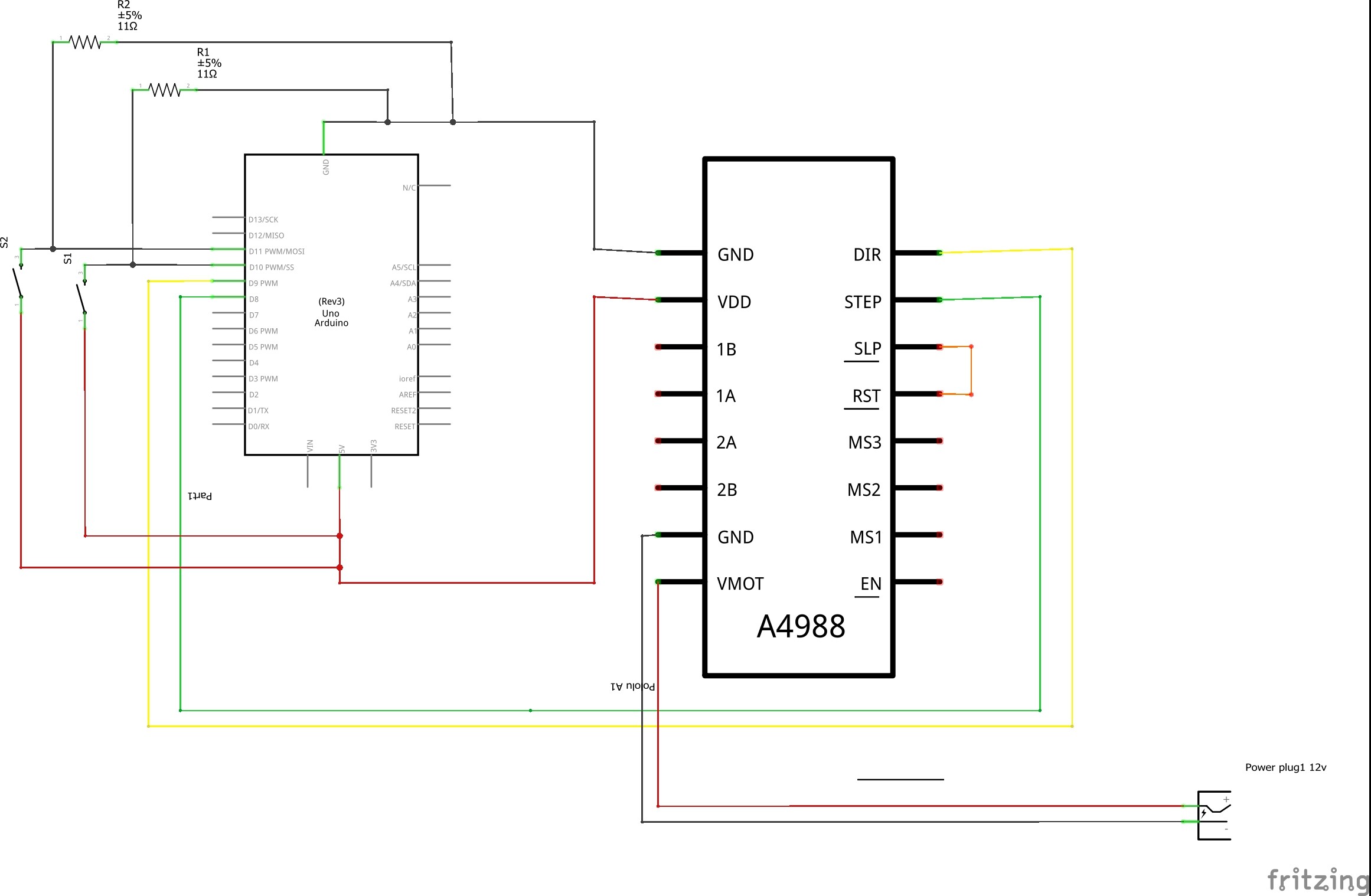

Is the following diagram effectively GND?
I still don't see any GND connection between the Arduino and the A4988.
A photo of a simple pencil drawing of your connections would be much easier to make sense of than a Frtizing picture.

If DMM = multi meter then yes I do own one. Here`s the wiring as requested.
I can't read the left hand part of the image even when I enlarge my screen.
With a simple pencil drawing there is no difficulty ensuring that all the relevant items can be read.
But if you insist on using your PC to make the drawing then have a look at the images in this Simple nRF24L01+ Tutorial that I created with LibreOffice Draw. You could the same thing with any drawing program.
...R

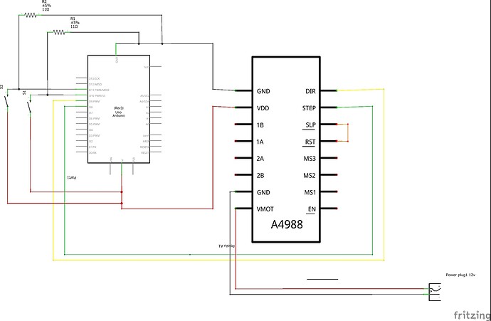

Is this any better?
If those resistors are 11 ohms that is much too low and will overload the Arduino I/O pins. Try 4700 ohms - you don't need much current for a switch. Better still use pinMode(pin, INPUT_PULLUP) and you won't need any external resistor.
...R
I think they are 22k as the color code is red red orange gold.
Is this correct?

Shoot - there was me thinking you had prepared the drawing carefully :slight_smile:
...R
At 11 ohms those resistors are stupidly small. They should be three orders of magnitude higher.
Grumpy_Mike:
Now two of us have wasted time on that issue :slight_smile:
According to Reply #32 they are really 22k
...R
