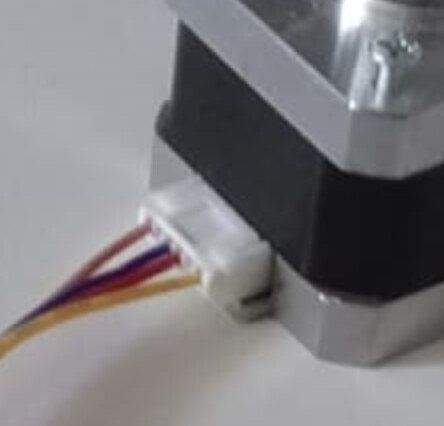

What exact type of stepper-motor is this. Does the stepper-motor have a nameplate with some numbers on it?
The connected
Seems to have 6 contacts but only 4 of them have wires.
It might be that this is a unipolar stepper-motor which needs a different wiring than a bipolar steppermotor.
If you have powersupply switched of and you unplug the connector from the stepper-motor how many male pins are on the stepper-motor?
measure resistance between all pins
and post your results
Your sketch in Post #1 works. Check wiring and power supply.
Post #1:
...says red&yellow on 4&6 is one coil, and orange&blue on 1&3 is the other. Seems like it might be OK from the #5 pic.

The motor was jerking back and forth in both directions, so there's a chance they aren't fried and they are bipolar for sure
I don't have the shield's or arduino's exact model as the seller's page is gone, but the exact model of the motor is this XY42HS34 19V:
Here's its datasheet:
42HS34-0956.PDF (66.7 KB)
As for the multimeter, I just ordered it, so tomorrow I'll post the results
The motor has 6 pins
