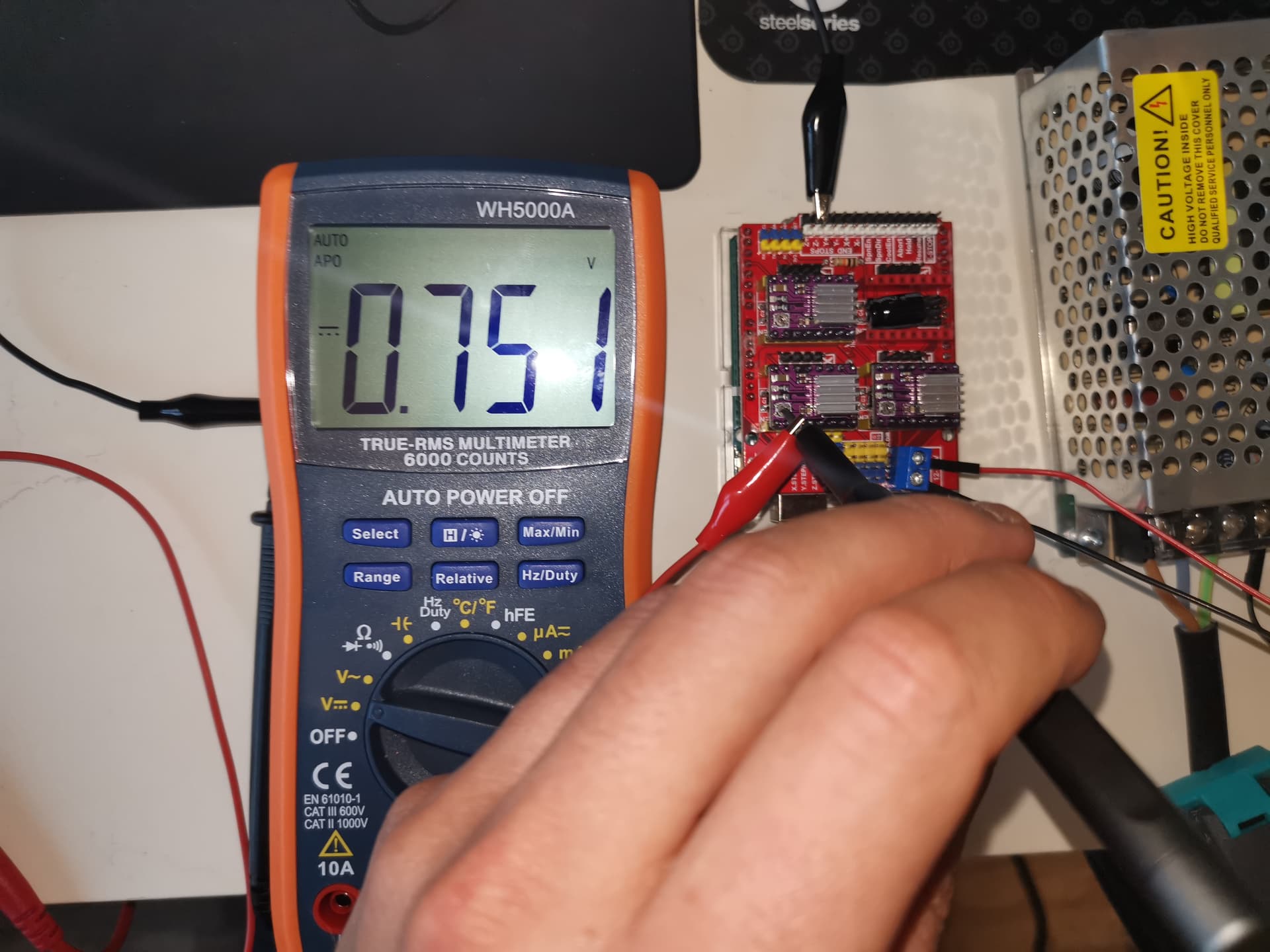

I setup Vref to 0.75V since the current per coil of my motor is 2A at max.

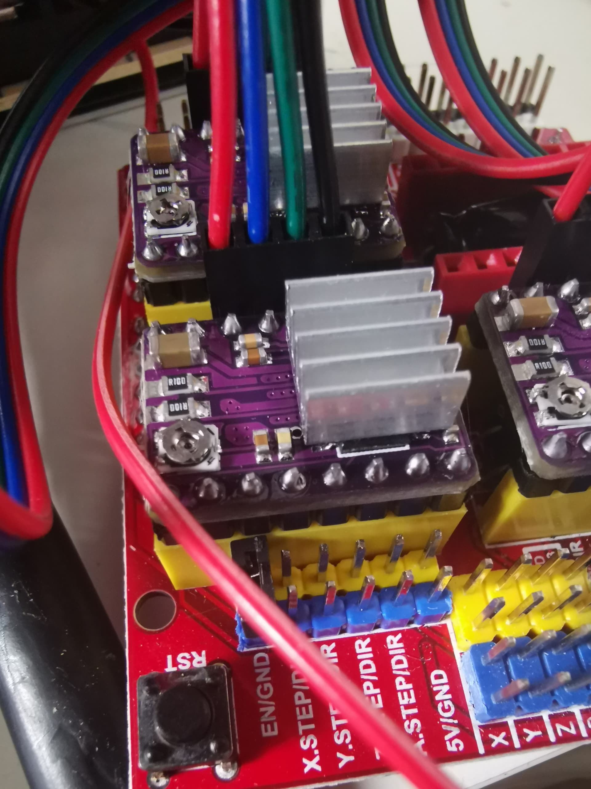

Here is a picture of my setup:

To setup Vref I followed this method (that you can find on the link above):
And you can see the result on picture below:

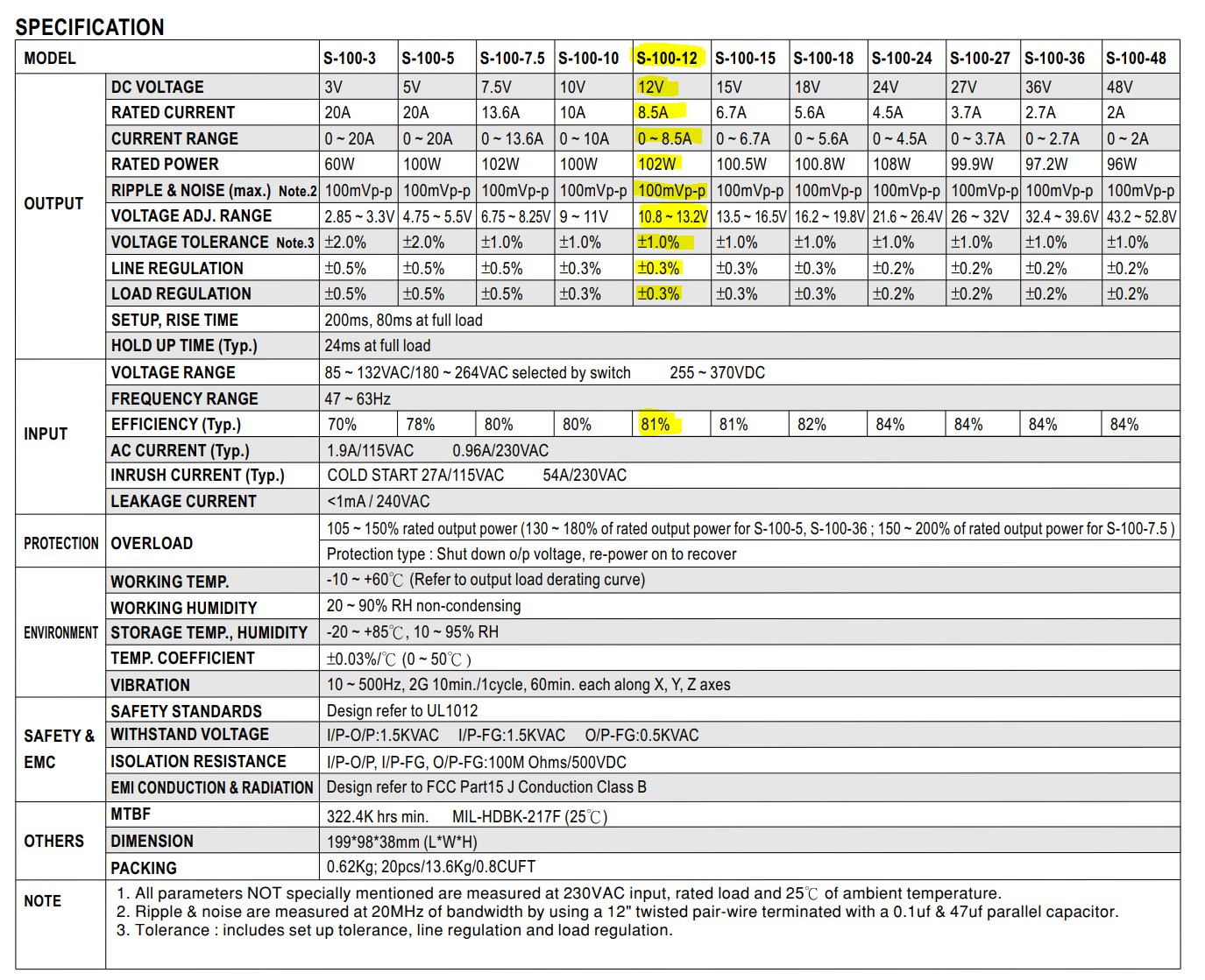

Regarding the power supply, it's a copy of S-100-12, the datasheet can be found here: https://www.meanwell.com/Upload/PDF/S-100/S-100-SPEC.PDF

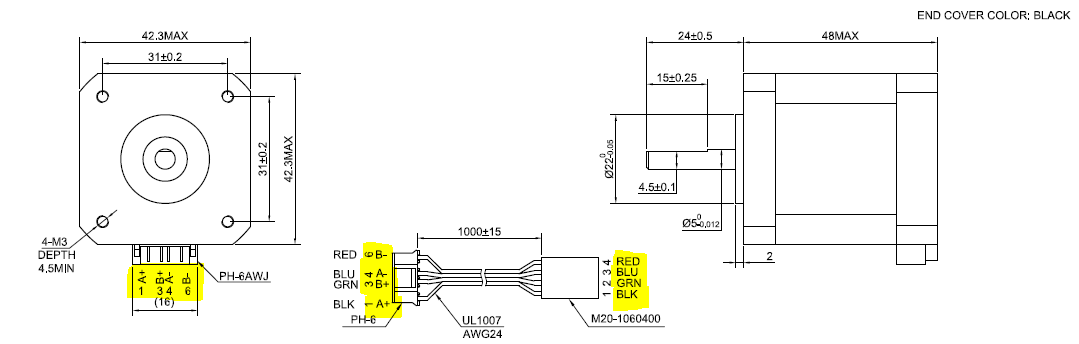

Usually if the motor didn't run but with sounds and ticking is due to : 1. Wrong frequency to drive, 2. No sufficent current, 3. Wrong wired.
From your attached photos, it looks wired incorrectly. I have the similar motors with 6 pins. 1.2.3.4.5.6. it can be used as bipolar (4 pins 1,3,4,6 as CNC shield needed) or unipolar (6 pins).
There are 2 wiring groups of this kind of motors : 1,2,4 and 3,5,6 In your pictures, your connection to CNC shield is 1(Black)-3(Green) to A drive, and 4(Blue)-6(RED) to B drive .
That is to change the same wiring (1-4) to A drive and (3-6) to B drive . Please swap one side of pin connect ( Black-Green-Blue-Red ==> Black-Blue-Green-Red)
Before you do this, can double confirm by checking the wiring with Ohm meter, see if the motors wiring are 1,2,4 and 3,5,6. Same wiring has very low resistance ( <10 ohm, depends on motor), different wiring has high resistance.

Sorry maybe I misunderstood your comment, but it is the S-100-12 ie the one I highlighted in below screencap:
Note that it is not the one from the meanwell brand though, it's a cheap power supply bought on aliexpress. I can't find any datasheet on the seller page. On the labelling, the ref is S-100-12 though, that's why I provided a reference to the meanwell products datasheet.

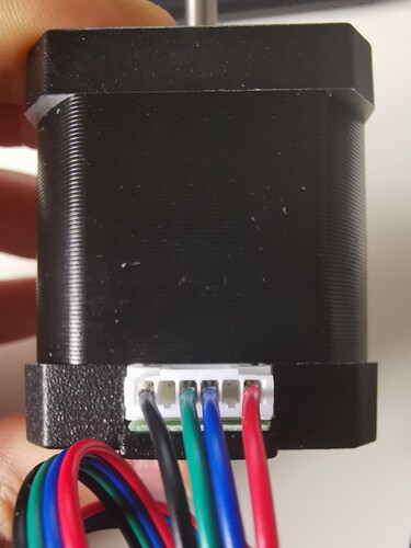

Thanks for your answer, you're correct, the wiring of the motors is:
1 - Black
2 - X
3 - Green
4 - Blue
5 - X
6 - Red
Like in the picture below:

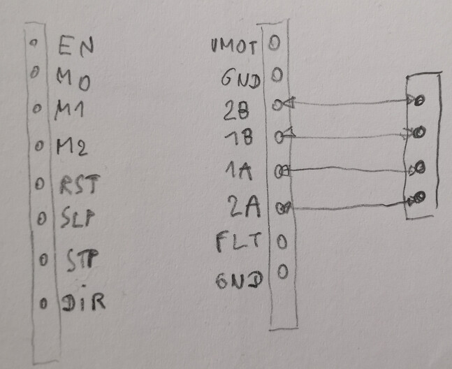

And on the CNC shield it is wired like that:
I will do this when I'll be at home and post results. Thanks again.
So to give a visual about what you're writing:
I double checked with my Ohm meter, and confirmed that low resistance is between pins [1 - 4] and [3 - 6], which confirms the statements above.

Then I checked the pinout of the pololu driver board, and verified with the Ohm meter how it is mapped with the 4 pins next to the driver on the CNC shield.
The connectors in question:
The mapping (pretty straightforward but a surprise happens more often than we think):
So that in the end, I just said again in a complicated way what you have already said here:
So I did this:
