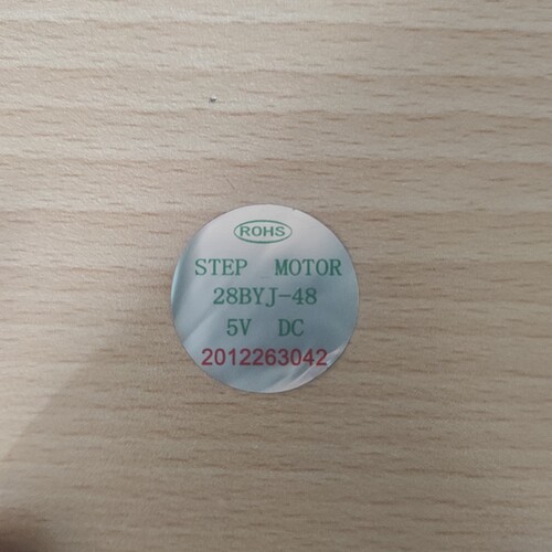

Hi guys, im new to Arduino so forgive me for my ignorance,
I need to make a sort of "valve" moved by a stepper motor, it has to move of 90 degrees when I turn on a switch and get back to the original position when I turn it off.
If possible id also like the Led's to indicate me the position of the stepper motor
Can anyone help me ?
Thanks

here:
/*Specifications
• Unipolar stepper with 0.1" spaced 5-pin cable connector
• 32 steps per revolution
• 1/16.025 geared down reduction
• 5V-12V DC suggested operation
• 9" / 23 cm long cable
• Holding Torque @ 12VDC: 250 gram-force*cm, 25 N*mm/ 3.5 oz-force*in
• Shaft: 5mm diameter flattened
• Dimensions: 28mm diameter, 20mm tall not including 9mm shaft with 5mm diameter
• Weight: 37g

If you use a stepper, you will need to have two limit switches, one each at the end of the stepper sweep.
These switches will also give you an indication of the position of the valve shaft.
Limit switches will also let you know where your stepper is when powered up, you would check to see if the HOME limit is activated, if not HOME the stepper until its limit is activated.
This way your code knows what position the stepper is in, before trying to control the valve.
Those 5V steppers are not very powerful, have you checked that it can turn the valve?
Tom....

For a lightweight value this is a good type of motor to run a value on and off. It has slow speed and reasonable torque for a 5V motor. But tomgeorge is right, if it is a heavy value it won't.
Note that, for this stepper/gearbox there is not a precise number of pulses to turn it exactly 90 degrees. The gearing is not even, so (when I tested one) it took 2037.5 (yes "point 5") pulses to turn 360 degrees.
So, if you are turning it 90 degrees one way, and then 90 degrees back it'll probably be OK. But if you are making full turns, you will need those limit switchs or something so you can determine a set position.
Note Also that the 12V version of that motor has noticeably more torque - just in case the 5V struggles to turn your valve.
