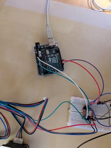

I'm completely new to working with Arduino and stepper motors. I'm trying to set up a NEMA 17 stepper motor using an Arduino R3, an A4988 stepper motor driver, and a 12V power supply. However, the motor isn't running; it's grinding and alternating with a low beep sound. How can I let it run (smoothly)?
I am happy to recieve any advice from you.
I got these components:
  • Nema 17
  • A4988 Stepper Motor Driver
  • Arduino Uno Rev3
Breadboard
Barrel Jack Connector Pigtail
Wires
Power supply 12V 3A.
This is my setup and wiring:

  1. Post a link to the actual stepper motor product page or data sheet. NEMA 17 tells us only the size of the motor mounting plate.
  2. Make sure to set the current limit on the motor driver correctly. It must be 1 Ampere per winding or less.
  3. Dramatically reduce the step rate. 1000 steps per second is a ridiculous starting point.
Try 10000 microsecond delay in the second delay. Eventually 20000 if 10000 doesn't work.
You are trying to make the motor move too fast without acceleration. Add a delay at the end of each loop code. Test the delay value and increase it until you find one that works.
Thank you so much for your answers and for taking the time to think this through. Now my motor is grinding with no beep sound. It sounds like it is working but not really rotating yet. Is it possible that something is just damaged and therefore not really working?
This is my Nema 17 and my updated code:

I also have the following wiring
The code you added tells me otherwise! Go back to the original code.
See you are delaying 700 microseconds between steps. Do you understand that code? Your motor cannot make steps every 700 microseconds!
Change the last delayMicroseconds(700) to delay(500) and see if the motor turns.
The motor is not working because you are not paying attention to forum members' instructions.
For example, you did not significantly change the step rate.
Set the current limit properly. This video explains the process for A4988 motor drivers from Pololu, but may not be correct for yours because the current sense resistors vary among manufacturers.
