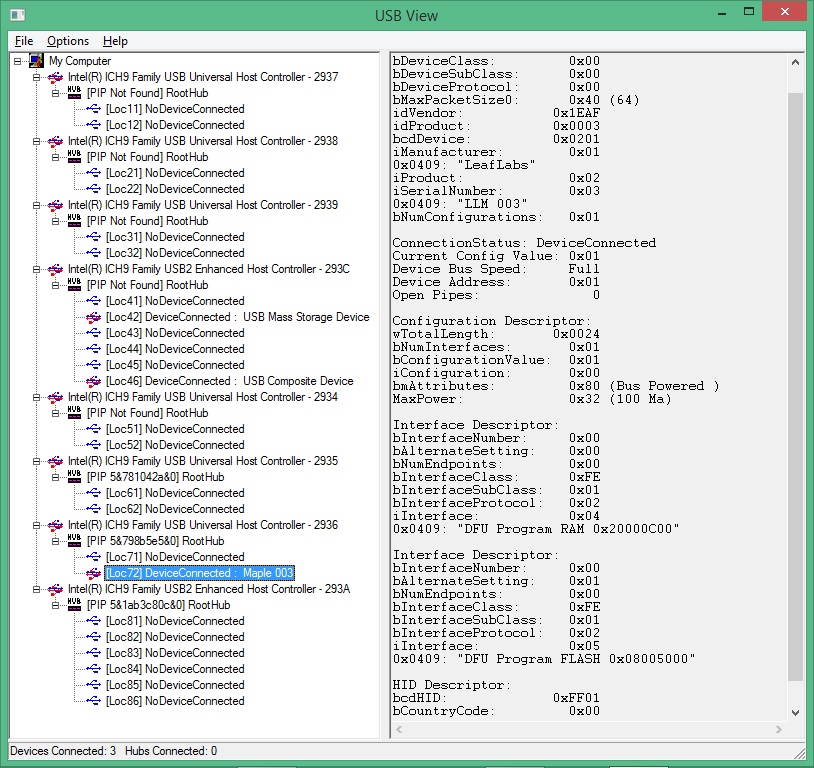

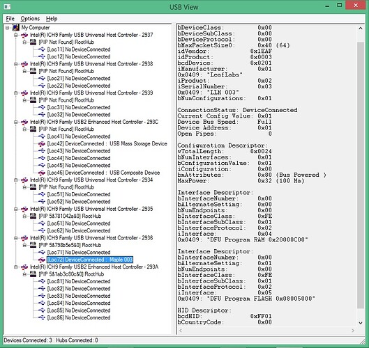

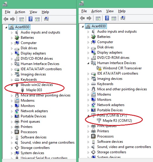

Device Manager showing the two USB modes of the Maple Mini: Serial / DFU:
From my experience it is not a perfect solution, but most of the time if serial is enumerated, the DTR line will reset the bootloader into DFU... maybe 9 out of 10 times. If I put the Mini in DFU mode, the success rate is 100%. Again, this is on par or better than my Pro Micro boards.
I found it very interesting that the DFU mode has a HID descriptor ... sounds like something to look into.
one last question. are you saying that you must put into dfu mode manually to get reliable loading? must one still press buttons with that method? or am i misunderstanding again.
Note: Please make reference to:
For a summarized version of pertinent information contained in this lengthly
thread. Also, some simple Mini Maple projects with source may be found on
my blog: http://www.hackster.io/rayburne
one last question. are you saying that you must put into dfu mode manually to get reliable loading? or am i misunderstanding again.
From my experience, for some crazy reason, even with the COMx port shown enumerated... sometimes, maybe 1 out of 10, the attempt to download a sketch will not work... an error message is displayed about not finding the board.
So if reliable means 100% of the time, then placing the mini into DFU always works... from the GUI point of view, the DTR is still plused and the download script then goes into DFU and the uC is already there.
But, I have seen the same behavior on Pro Micros with USB based on LUFA. Maybe it is a Windows only problem - I simply do not know. But, since I am aware of this, 9 out of 10 perfect downloads is not bad.
Ray
