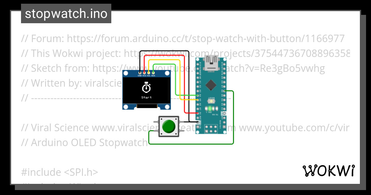

Hello, I wanted a stop watch in which when I press a push button the clock will stop, then when I press it again it will continue the timer and not restart it. What do I need to change in the code order to do this? I got the code from here.
Here is the code

This is called a "lap timer."
The code is not well-written. You can make one more 'fase' to add the lap time.
If I wanted to change that sketch, then I want to go through every line of code and make it more normal code.
I used the original sketch for a Wokwi project, so everyone can try it:
@Koepel , please post the code here.
If I want to respond I first must go off to Wokwi to see what is posted there so that I do not duplicate. Or not contribute at all.
I don''t want to go to an external site to see what a helper posts any more than I want to go to an external site to get information from the OP.
Sorry, I should have explained that it is the same sketch (but with the "viral science" reference).
The Youtube page: https://www.youtube.com/watch?v=Re3gBo5vwhg
There you see a link to the sketch.
The Wokwi page is to play with the code of the Youtube video.
:arrow_right: Now the real problem. What can we do with that sketch ? It starts by adding debouncing for the button. Then rewrite parts for normal code. Then adding a Finite State Machine. Then using normal names for the variables. I'm already tired thinking about it.
Which Arduino (UNO/NANO/MEGA) you are using?
And what is the time format?
HRS:MIN:SEC (xx:xx:xx)
or
MIN:SEC:1/00 of SEC (xx:xx:xx)
