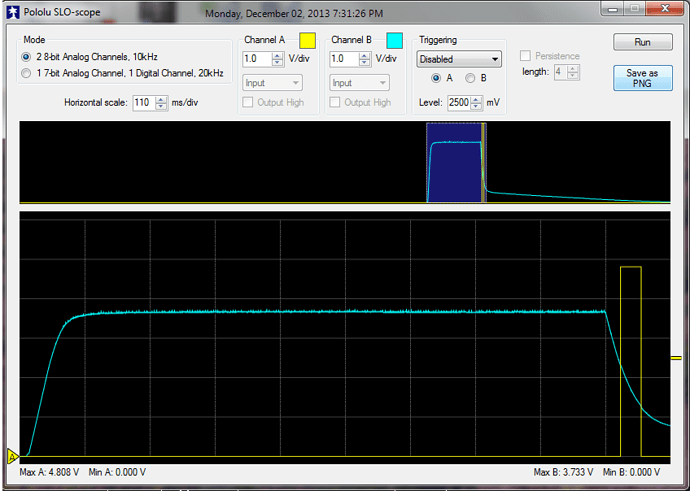

The concept is to measure the duration of a squarewave and based on the length (1 sec, 3 sec, 5 sec,7 sec) activate a solenoid via n-ch mosfet. I have done this via interrupts looking for the rising edge (start timer) then falling edge (stop the timer). Everything working perfectly.

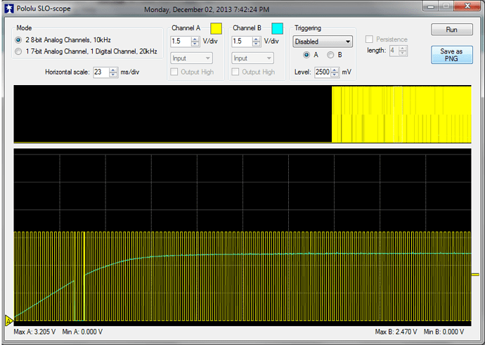

The problem came when i encountered a grounding problem and had to make a dc-dc converter. In short, I just made a 'dirty' quick fix, using another n-ch mosfet to do the switching for me(again this works fine on its own). Then assigned a pwm to take care of that, when i did this however i screwed up my first part of the program. Once i take out the pwm it works fine again... where is the problem???
Its doesnt appear to be the hardware. I checked the PWM it seems fine, i can upload o-scope pictures.
IF this helps, i noticed that if i enable my pwm but just don't connect that pin to anything else (o-scope, mosfet) it works fine but then obviously the dc-dc converter does work.
