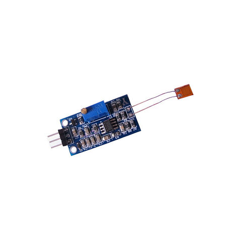

Dear friends, I need an urgent help, because I did not find reference in the forum.
I have a strain gauge, I need the arduino to read the variation and every time I vary open or close a door for a certain time 3 or 4ms,
Someone can provide a path or where I can find study material for this sensor, sorry for the English. :o
Sensor
Hi, I think this module would not be right for what you want.
About use of strain gauges see this link:
https://create.arduino.cc/projecthub/150199/e-structure-uno-1348d4?ref=search&ref_id=e-structure&offset=0
You must be superman, being able to pass through a door in 3-4 ms!
