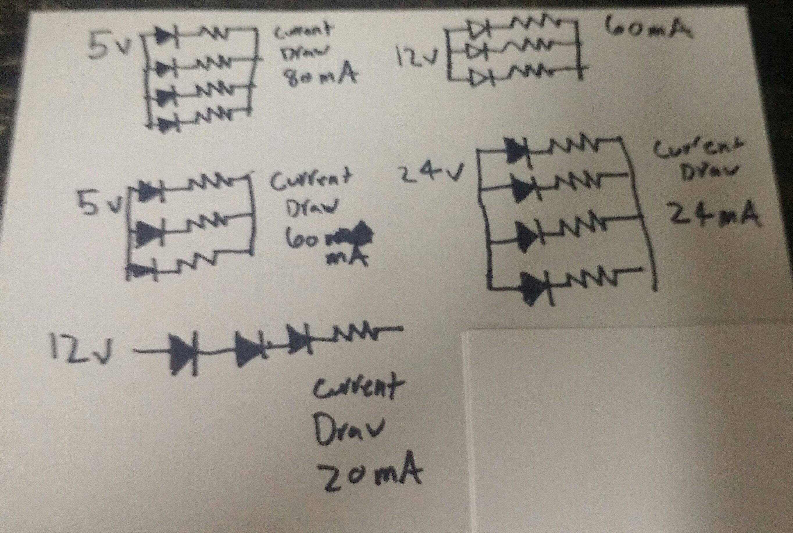

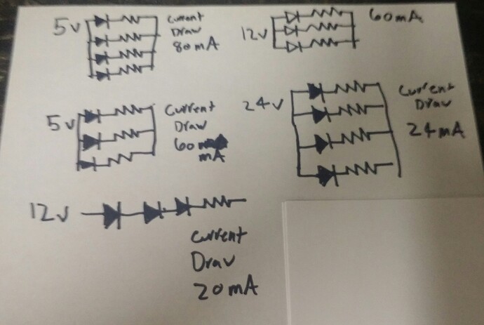

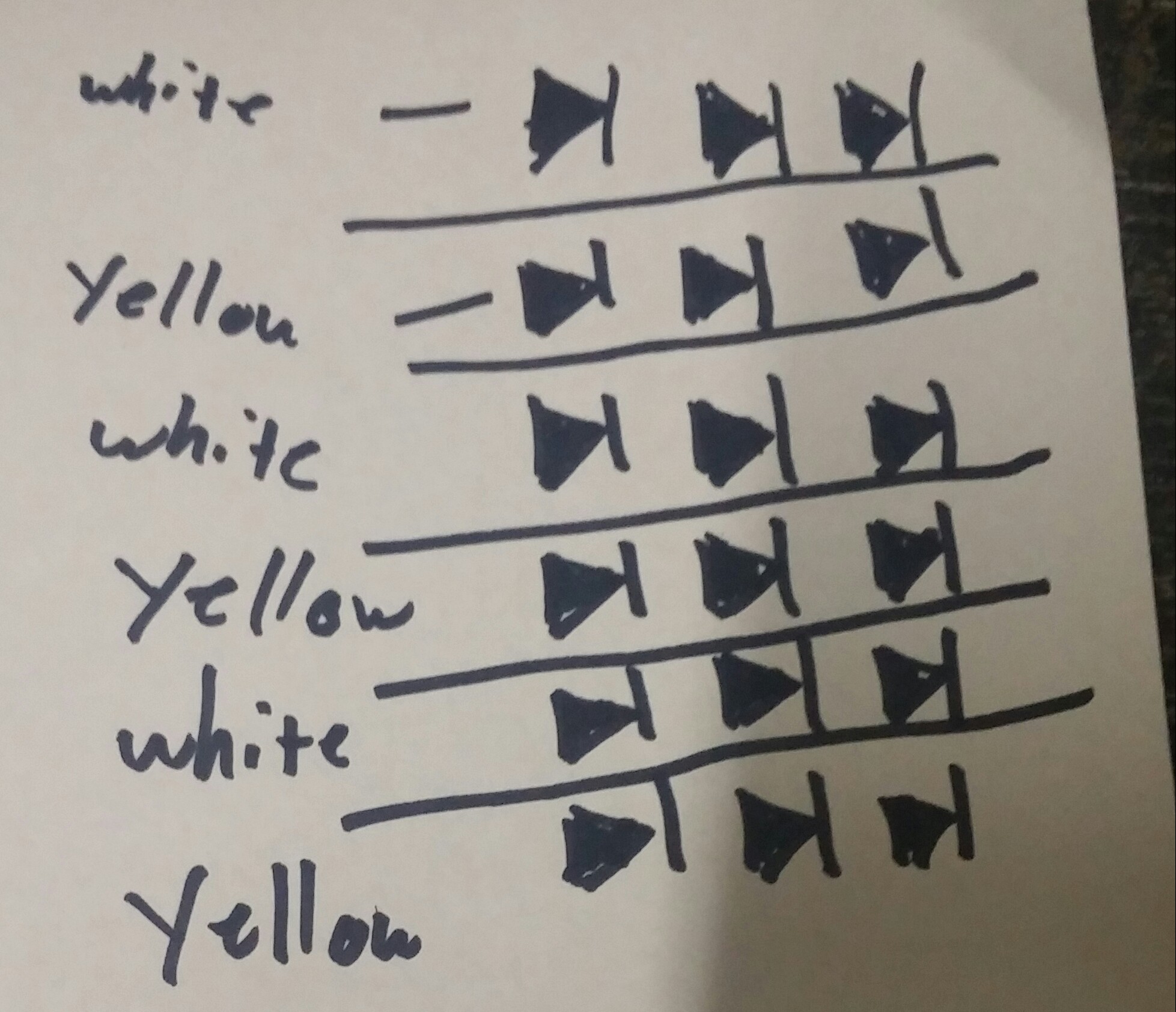

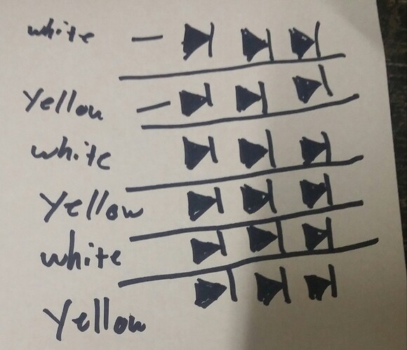

I'm sorry for the lack of detail. I will post a few horribly drawn pictures below to help explain what i meant. I forgot to add in the first post this is going to be battery powered.
On the 3x6 string it is a total of 18 bulbs, 9 white, 9 yellow. If i can figure out a way to do the prefered 4x8 it will be the same 50/50 split
So my understanding is each output on the arduino can supply 5v 40 mA. So it seems like my options are to either keep each column under that 5v 40mA or use relays. (This is coming purely from google searches). it looks like to fit under the maxium mA on 3 of my LEDs I would have to use 12v, However that is over the maximum voltage. If i use 5 volts on 3 of my LEDs I am at 60 mA. When I started this post I thought 5v on 3 of my LEDS was under that 40mA cap.
Each row will be all on or all off. I would like to be able to turn all of the white ones on at the same time if possible. I know I am missing some really big and obvious that is right in front of my head. I am sure I left out a ton of needed detail.

You are correct that the max current from any Arduino pin is 40mA, but that is not a good idea for long term use. 20mA to 30mA is better for long life. Also there is a 200mA limit for the ATmega328 chip, ie. all pins together. And there are other limits too.
To overcome these limits you will need transistors or an extra chip such as uln2803 or tpic6b595 or max7219 as suggested.

FYI, rapid flashing with relays is not a good idea. They can only switch at relatively low speeds, and if you push them, they make a terrible noise and wear out in no time. To make matters worse, an Arduino cannot operate a relay directly because relay coils usually need more than 40mA. So you have to use transistors to drive the relay coils (Arduino relay boards have the transistors built in). But if you are going to use transistors, you might as well drive the leds directly and forget the relays.

Looking at your drawings in post #3, a single TPIC6B595 could control 8 groupings of 7 or 8 LEDs in parallel from 5V.
Each output can sink 150mA continuously.
It is just a shift register, so all would do is shift in 1s for the outputs you wanted to turn on.
