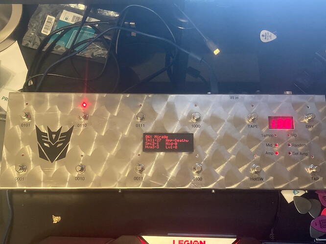

Hi all,
I've built a MIDI floorboard using an Mega2560 Rev3. I'm using WIN10 and the latest Ardunio IDE. Everything works fine, apart from the names that I give to certain presets. Somehow they get displayed incorrectly and the error seems to be somehow correlated with speed of the script. I noticed the names get displayed correctly when adding a long Serial.print function right at the beginning of my void loop(), which slows the responsiveness of the device down so much, it basically becomes unusable. If I remove the Serial.print code lines, the pedal is super responsive but the issue returns.
I'll post all my code (it's somewhat comprehensive) because the issue might be somewhere I do not anticipate it.
Basically, there is a struct list called Presets that has all the names and MIDI values for the 10 sound Presets, and then, there is another struct list that contains all the amplifier presets with the names and their respective MIDI patch values.
One amp preset is called "Death", but the HD44780 (i2c'd) as well as the SerialMonitor write "Deathw". or "Deatho". Sometimes, the preset "SRV" gets misspelled as "SRVi" or "SRV(". And if all the amplifier presets are spelled correctly, the first effect preset called "obZen" is misspelled "ooZen".
Things I have tried that didn't fix the issue
- several lengths of names ("deathhhh" - gets misspelled "deathohh")
- different definitions of char sizes
- various USB cables
- various USB ports
- powering the floorboard over either USB or 9V or both
- various baud rates (MIDI only really works with one though but SerialMonitor has options)
- various delays in the void setup and / or void loop
- asking ChatGPT for help (which suggested null termination and displaying individual characters but couldn't reeally help
- asking my wife for female guidance
- coming back to it after a while
This is the serial monitor's output when the amlifier is misspelled
18:39:20.476 ->
18:39:20.476 -> 0 3 1
18:39:20.476 -> 06: Mirage
18:39:20.509 -> Deathw
18:39:20.509 -> print(int num)
18:39:20.541 -> print(long num,int digits)
18:39:20.541 ->
Here's the Serial monitor's output when I tell it to display all the characters of the preset individually... the effects preset becomes misspelled
19:02:56.180 ->
19:02:56.180 -> 0 3 1
19:02:56.180 -> Original ampPreset[activeAmp].name: Death
19:02:56.180 -> Character at index 0: D
19:02:56.180 -> Character at index 1: e
19:02:56.180 -> Character at index 2: a
19:02:56.180 -> Character at index 3: t
19:02:56.180 -> Character at index 4: h
19:02:56.180 -> Character at index 5:
19:02:56.180 -> Character at index 6:
19:02:56.213 -> Character at index 7: (here's a symbol missing - basically a square box)
19:02:56.213 -> 01: o�Zen
19:02:56.213 -> Death
19:02:56.213 -> print(int num)
19:02:56.213 -> print(long num,int digits)
19:02:56.247 ->
19:02:56.247 -> 0 3 1
Here's the device (just so you have a pic)
And all my code (the screensaver logic is in another tab, but it does not affect the error).

If you have any (!!) ideas on how to make it work, please push me in the right direction.
Thanks in advance.
Pete
