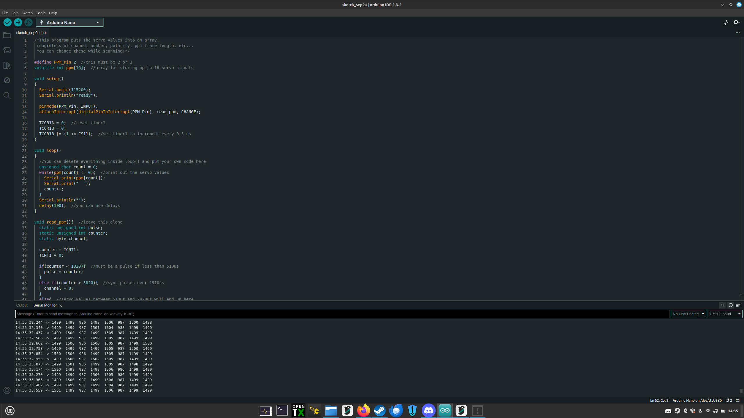

Sorry. Here is an image of the devices. I'll attach the code later.
Try connecting any ground from the RX to an Arduino ground.
Still getting bad values. Thank you for the suggestion!
The screenshot is what I see even if I use other PPM encoders in the library. The code in the photo is what was sent to me as a working project. All I needed to do was connect a PPM receiver and connect the servos.
How are you reading the PPM stream in your Nano?
Please post your sketch so I can replicate your setup.
In the meantime here is a test sketch that prints the PPM channel values.
Connect your receiver PPM signal to pin 2

This is a snippet of the output I get if I connect a cheap 8ch drone receiver to it.
1508  1493  993  1506  1987  1993  994  993

The maximum channel jitter I see is about 4 or 5 microseconds.
That's it!

The channel results from the test sketch in your screenshot look perfectly fine, so it's not a hardware problem you are having.
This is a huge step forward never or less. In his video on youtube, he does have his aircraft flying. I'm happy It's not a hardware problem but now, I need to do some more learning... I'd much rather fix something with a screwdriver than do stuff with code.
Unless he sent me the wrong files? or there could be something commented out that I have missed? The error could still be down to me.
You may have misused his code, which is quite likely considering you didn't understand it.
For example, this phrase looks like an error...
...since pin 4 of the Nano does not have an external interrupt
