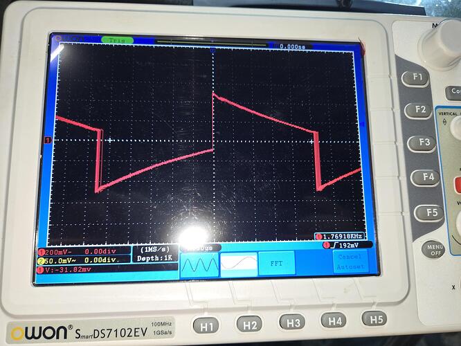

The tractor uses a VR sensor for RPM feedback. here is a scope view of the raw signal.

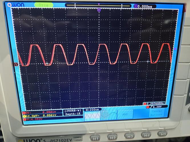

I picked up a Mini Max A2, was told i could wire vr sensor directly to board from seller so went forward with testing.
This is the scope signal i got out of output of board. it is not what i expected to see. I am pretty sure its not correct either, but you good folks now more than I.

I suppose we should start with the VR conditioner and what I am seeing for the signal input and then work on the code.

I think your scope is set to AC input.
Set it to DC and you should see a nice 0-5V signal

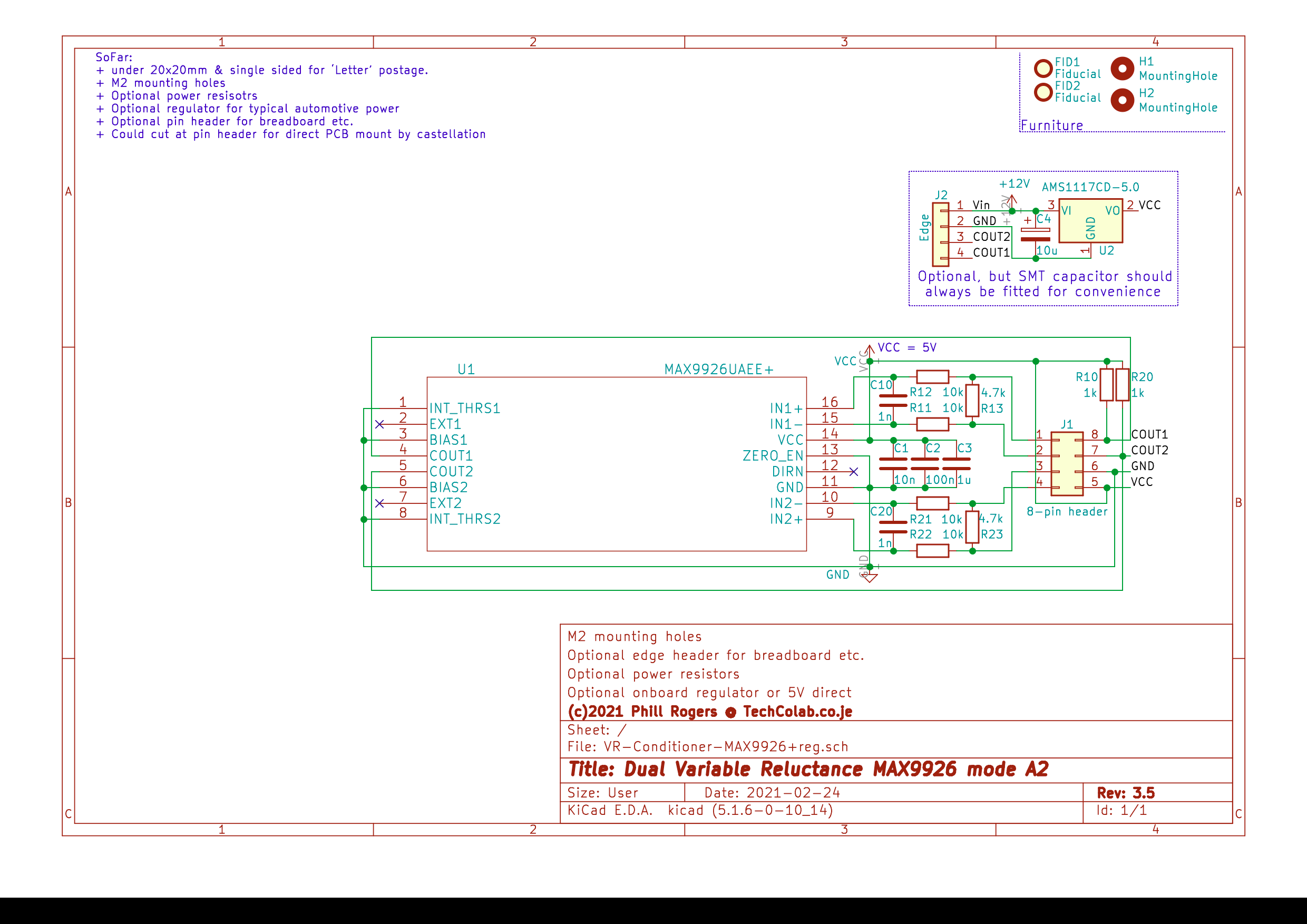

Stay with the MinMax A2 board. It would be difficult to duplicate it's functions with a DIY circuit.
Not much to the A2 board, this schematic is from the speeduino website

The Hall sensor doesnt pick up anything with the magnet removed. So i believe im good there.
I orentated the sensor to the magnetic field of the magnet. Testing it by turning the engine over by hand.
As far as magnetic field being to strong, ive done a bunch of reading... i dont believe it to be, but :man_shrugging:
It triggers just before leading edge if magnet passes by and drops out just after trailing edge goes by.
These fulty reading are concerning to me. And i will investigate them further. But now that i believe that issue occurs at higher rpm. Im more focused on the PID perameters and getting the engine to idle smoothly without pulseing from 400-1200rpm.
Do you remember studying magnetism in school? With the magnet in place , the whole pulley becomes a magnet because the magnetic field now has material to propagate the field. So you want a magnet with the minimum strength to trigger the sensor, but will be too weak when flowing through the pulley to produce other points that also trigger the sensor.
Thanks for replying.
Ok, yes. I see the point your making.
I dont know the strength (Gauss) of this particular magnet. Its prabably 5/16" diameter by maybe 1/8" or less thick. (I know size doesnt represent field strength)
When adjusting sensor i started at a distance then moved sensor closer to magnet untill it tripped then just a smidge (technical term :rofl:) more.
The bolt with the magnet is also set out at least 1/8" more than the other bolts.
Unless something is changing at fasterspeeds i am confident im not seeing any false triggers.
I can rotate engine by hand and only get a triggered responce at the intended location, once per revolution.
