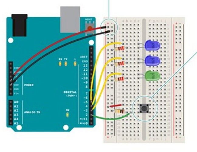

I'm a newbie at the Arduino project. I'm trying to do the project 2 spaceship interface. But I'm stuck on the first section' builds the circuit'. I did exactly the whole steps but still the leds won't light up. Has this something to do with the resistors? I'm not finding the resistors that they are asking for in the Box. Can somebody help me to do the first step of this project?

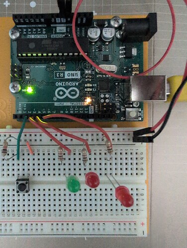

This is my setup. Thank you guys for the tips. Used all of y'all information. The LEDS won't work . I checked them all apart and they work individually. I put the long leg correctly.What am I doing wrong.
Hi @barraz. I see a problem here:
i
The resistor lead is inserted into row 12 of the breadboard, while the LED lead it is intended to be connected to is in row 11 of the breadboard.
From the picture, I can't tell whether that LED's jumper wire (the red wire connected to pin 4 on the UNO R3) is also shifted down one row from its intended connection at row 10 in the breadboard.
I did the change you
told me

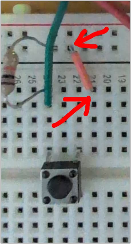

Now there are two new problems here:
This jumper should connect the 5 V rail of the breadboard to row 22 on the breadboard. But you have it connecting the GND rail of the breadboard to row 21.
Fix that problem and then check to see if the project starts working as expected now.

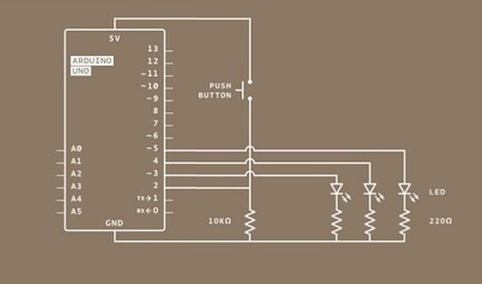

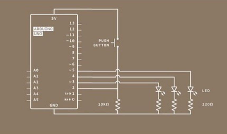

Do you understand this schematic?
Or are you just trying to make your circuit look like this one?

I'm a newbie. But I do understand the schematics.
I did what you told me. But still nothing
It looks perfect now. This is excellent progress!
At least from looking at the copy of the Arduino Projects Book I have (which is from some years ago, so might be outdated), it seems like the book doesn't very clearly state this, but you must upload the Arduino sketch code to the UNO R3 board before it will behave as described in the book. This is different from the "Get To Know Your Tools" project (project 01), where you are actually only using the UNO R3 as a power supply and thus don't need to run any specific Arduino sketch program on the board for the project to work.
