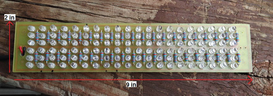

I have to make a lot of circuit boards, and its going take whole bunch of soldering by hand. I want to know what other options are out there that could make life easier?
Each board holds 120x 5mm blue LEDs and 40x 220ohm 1/2w resistors
(320 things need to be soldered)
And I have to make 13 of these boards

I would place the resistors on the back instead of the front as shown.
Resistor arrays would have reduced a lot of the tedium of populating the resistors, assuming the
power dissipation would have permitted it.
But in the future consider getting quotes for getting it built, using all SMT. If everything
is in a regular array it will minimize setup costs for the pick and place, but I suspect its
still expensive for a small run.
With SMT you solder everything with an oven in one go - you still have to pick and place, which
is just as tedious as soldering if done by hand. 320 items is still 320 items.

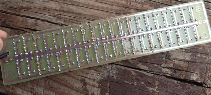

I guess soldering wouldn't be so bad if I had good soldering iron.
My tips keep turning black on me. I clean them every few minutes while using them, tin them as well but they keep turning black on me and I can't put any solder on them. But I guess they don't make things like they used too.
Not if one buys low quality soldering tools to start with. I don't have that blackening problem with my iron tips.

Sounds like a temperature problem.
What is your iron set to?
Use ~350C

Use a new soldering iron tip. Get a decent one. Trying to solder that many things with a known oxidized-beyond-usefulness tip is more pointless than Sysiphus' job.
Then bend your leads so they don't fall out, it should frankly take you more time to stick things onto the board than it does to solder them. Hot iron, 1-2 seconds is all it takes per point. For big through hole things, using at least 1.0mm solder wire also helps speed along the process. Don't bother using ultra thin stuff.

also type of solder I use is (mg chemical 22 gauge sn60pb40 solder) seems work well for me

I can't control my temperature with my irons, I was planing to buy one because I do a lot of soldering. Store near me sells a wlc100 weller.

Clean every few joints, with wet sponge, re-tin immediately after cleaning. Turn iron off if you are leaving it
for more than a couple of minutes (and re-tin it before switching off).

I don't really have a problem with cleaning it. But I should turn it off more while not using it.
How are you keeping the components in place to solder?
Tom.. :slight_smile:
I found with an LED array board I made up from a kit that laser-cutting a sheet with holes
in the right places made lining up the LED bodies neatly very easy, and stopped them falling out!
I place components in PCB, cover with 3/4inch sponge sheet and back up with board, tape or rubber band the assembly together.
Flip the assembly, the board and sponge keep the components in the PCB.
Solder one lead of each component.
Remove sponge and then align component if necessary and solder the other pins.
