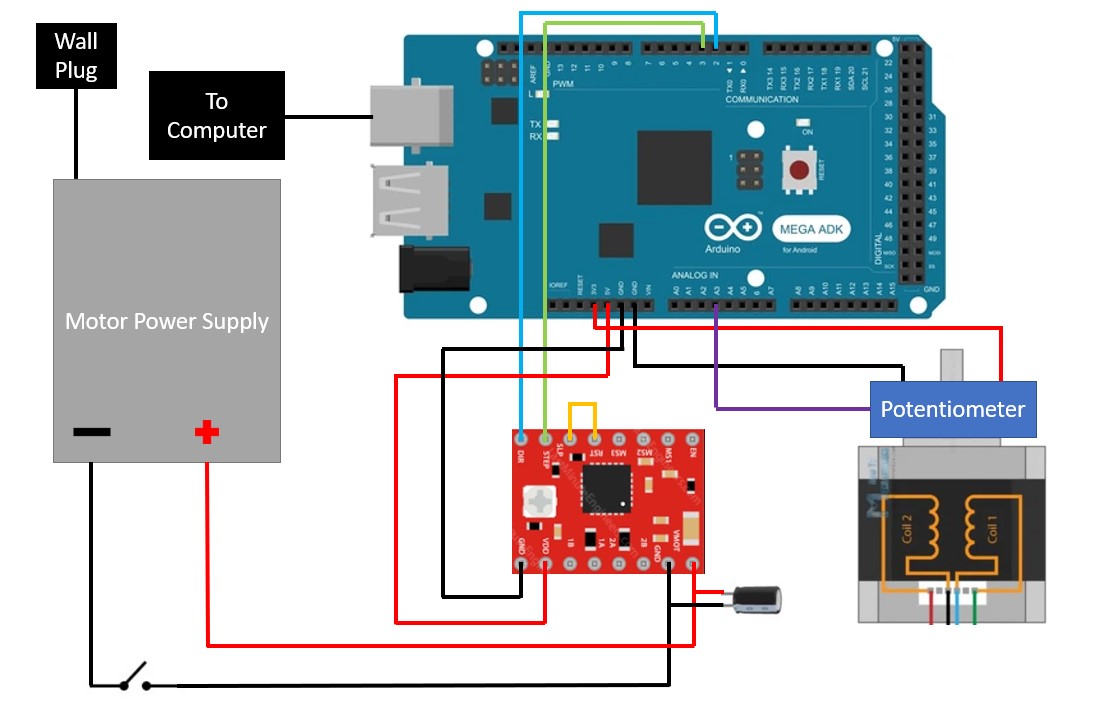

Hello,
I am trying to accomplish the following:
I have a toggle switch, a stepper motor, and a hollow shaft potentiometer that sits on the motor shaft. When the state of the toggle switch changes (e.g. switched from one side to the other), I would like the stepper to move to one of two specific positions, call them "open" and "closed". To move to the open position from the closed position, the motor has to turn CCW and in order to move from the closed position to the open position, the motor has to turn CW.
Here is the picture of my setup:
I am using an Arduino Mega, an A4988 driver, and a NEMA17 stepper motor. I have not included the connections for the motor, the toggle switch, or a blue LED with a resistor that I have connected in the picture because I was afraid it would make it too difficult to see the other connections. The blue LED with a resistor is connected in parallel with the motor power supply, just to make sure I'm actually getting power. The toggle switch is connected to pin 28 and a ground pin.

I have tried double checking the motor connections, and checking my driver, but they seem to be working and connected correctly. I'm guessing it's something with my code, since the motor works perfectly with the test program I used when I first connected the potentiometer (see above), but I'm not really sure where to go from here.
Any help would be appreciated! Thanks!

  • For slow switches, simply scan them every 20-50ms looking for a change in state; no debounce library needed.
You are right on. That is why we ask for an annotated schematic. Also many of us do not have the parts in question so the frizz stuff is just a colored blob with missing or fuzzy nomenclature.
The library looks OK, but the switch is not shown in the wiring diagram. Please post complete wiring diagrams (images of pencil and paper drawings are preferred).
To debug the stuttering, put in Serial.println((millis()) statements to examine the startup timing. Be sure to use a high serial baud rate, at least 115200.
Also @LarryD suggested, post a close up, focused photo of your wiring. Hopefully you are not using a breadboard, as they cannot support motor currents. The tracks burn and that eventually leads to destruction of the motor driver.
Ok, I will post an annotated picture with everything in it and print the millis, like you suggest.
Currently, the wires are all jumbled together inside a control box with other electronics. I can send you a picture, but it will just look like a box full of wires. Would it be helpful to put the circuit together using a breadboard, just so everyone can see what the circuit looks like neatly?
I just noticed that the only time the stuttering happens is if the motor power supply is on before I connect power to the Arduino. If I download the program while the switch to the motor power supply is off, wait a second, and then turn the motor power supply back on, it doesn't happen. It's almost as if the Arduino is trying to move the motor before the loop starts.
