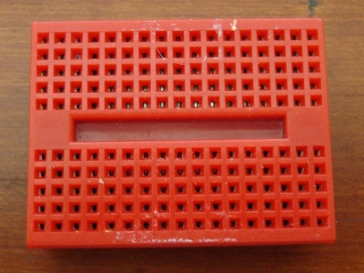

Here is my equally tiny breadboard. I used its adhesive backing on a project (can you find it?) and when I broke it off the back plane (just paper) fell off. You can see very clearly how the tie points are connected! The domes are rubber feet so the board wouldn't easily short itself when it's on metal surface.
