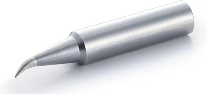

99.9% of the time, I use the T18-BR02 HAKKO curved tip.

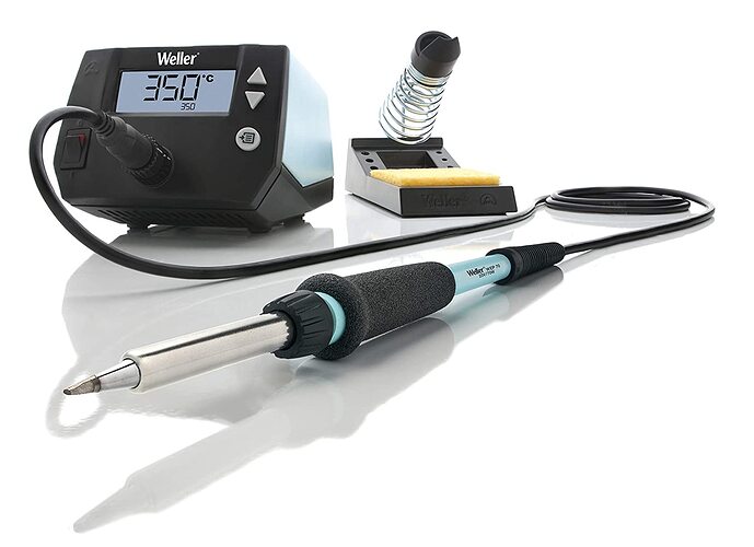

I would say get something with variable heat, changeable tips and that can go up to 450°C+
I'm using a Weller as well, something similar to this but an older model (not within your budget though)
