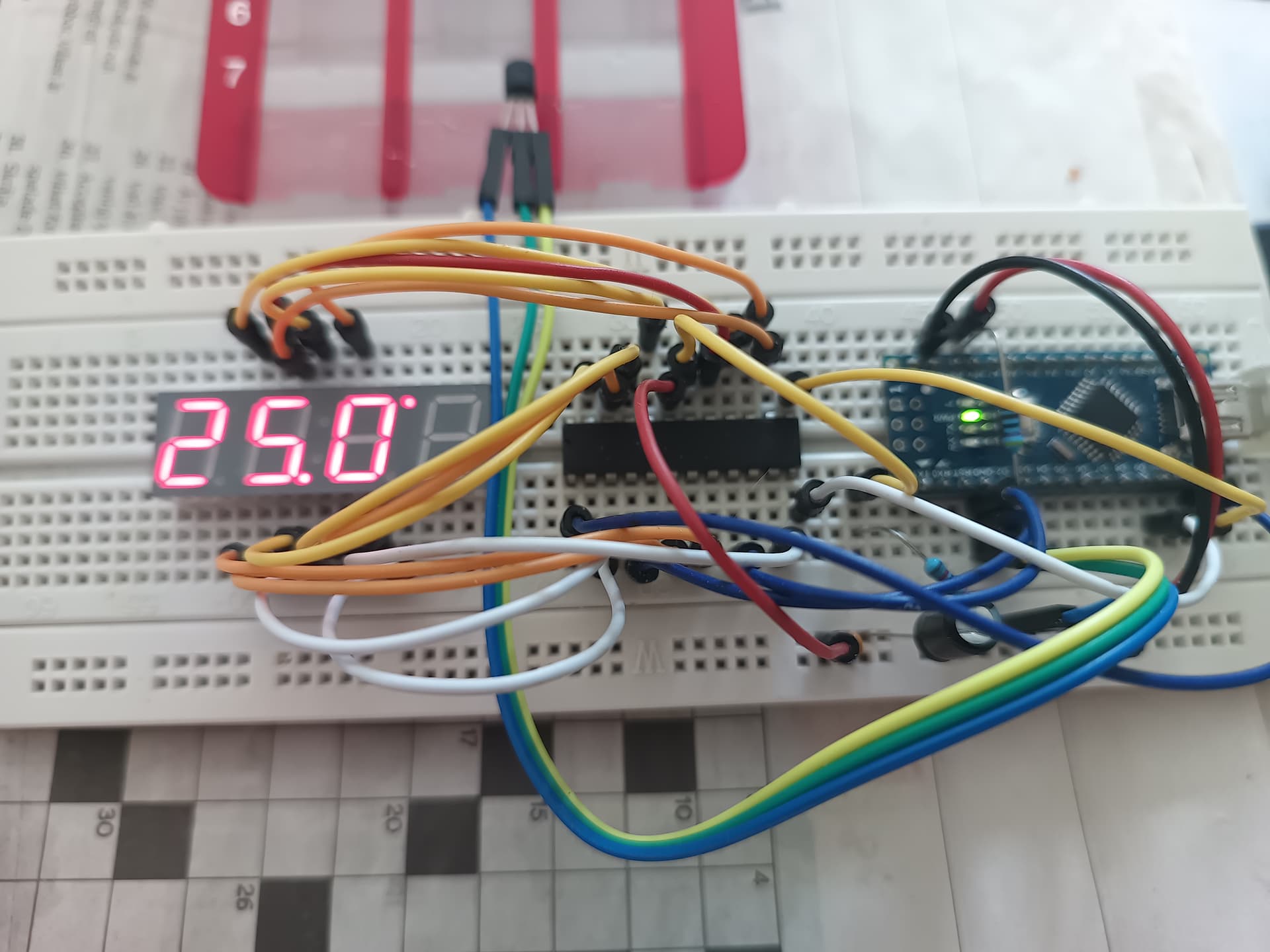

That is no help. The MCU is at place A, the display is at place A, the interface board is at place A. The thermometer is at place B and is connected to the interface board at place A.
Is that your plan?
My question was for the cabling in general. The thermometer status right now is at the breadboard state.
Edit: The wires for the sensor is wiggly, so minor movements of the contraption shows Err :upside_down_face:

Which wire specifically, you have sensor wires(3), and interface board to MCU wire.
Your picture which is unreadable appears to have many more for some reason.
The legs of the sensor are thin and doesn’t make good contact with the jumper wires..
Later on proper fitting will be done, with more sensors, and connection serial → Home Assistant.
It’s a Nano clone connected to a MAX7219 driving the display.
