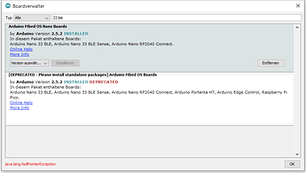

Hello Forum,
I'm trying to use the Arduino nano 33 BLE with the midi-library Surface-Control: GitHub - tttapa/Control-Surface: Arduino library for creating MIDI controllers and other MIDI devices.

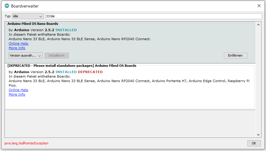

As far as I understood, in order to compile for the nano 33 BLE I need mbed OS, which I installed:
I did that but when I try to compile and upload I first get the following message
WARNING: library Control-Surface-1.2.0 claims to run on avr, sam, samd, teensy, esp32, esp8266, megaavr architecture(s) and may be incompatible with your current board which runs on mbed_nano architecture(s).
which I find very confusing as the documentation page clearly states that Surface-Control supports the nano 33 BLE:
When I try to flash the same code on my Arduino Pro Micro it works flawlessly and connects to FL Studio without problems.

Version 1.2.0 does not support the Arduino Nano 33 BLE, you'll have to use the master branch.
The page you linked to is the README of the master branch, not for version 1.2.0 (which is here: https://github.com/tttapa/Control-Surface/tree/1.2.0#supported-boards).
The lines in question are in the Arduino Core, not in Control Surface.
If you download the master version I pushed just now (656ae50a04078ebcdbaafccd6189668ef73be914), you shouldn't need to patch it anymore.
