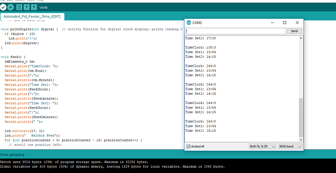

Hello good day! I did this and I added a SerialPrint command in the feed() function to show the current time, feed1 time, and feed2 time. I attached a screenshot for the output. The feed times looks to be correct, but the current time displayed is wrong. It supposed to be 13:53 for 1:53pm but instead it displayed 135:3, and it seems to reset to a value of 244:8 at the next execution of the function and it stays there.

I am not going to waste the time downloading and viewing a picture OF TEXT.
Post the text AS TEXT!
Then your ARE crapping on memory you don't own, somewhere.
You have WAY too much code for solving this problem. Pick 90% of to dump. Leave the code for reading the RTC. Does just that code work?
Start adding code back in, to read the encoder, for instance. Test, thoroughly, each piece of code that you add. The last part that you added, before results went pear-shaped, is the part of the code that is wrong.
