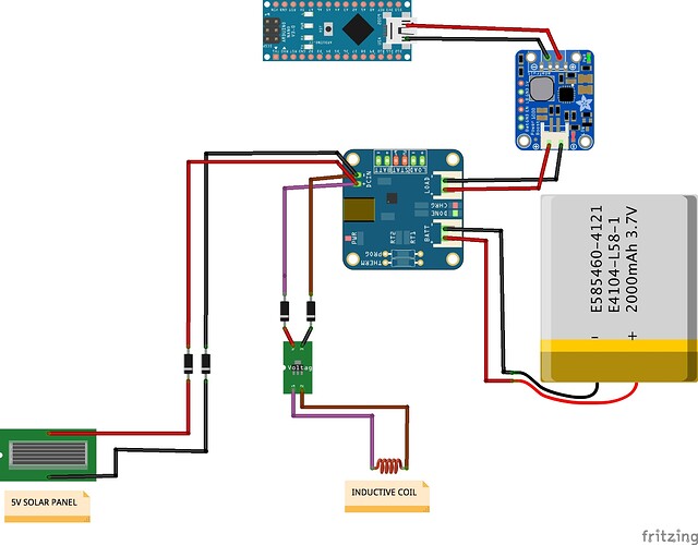

My first lead was to use power MOSFETs but the folks at Adafruit advised me to simply use diods instead to protect each input. Which kind of diods should I use?

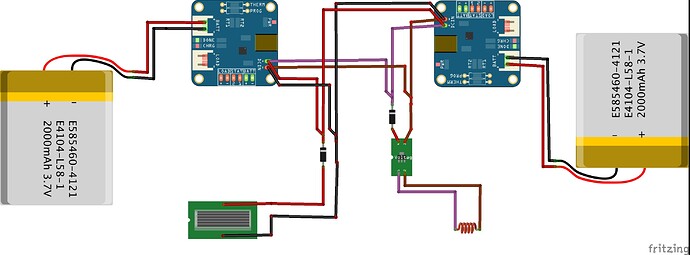

Would this work with the attached setup? It may sound like really stupid question but I really want to be sure of what I'm doing.
I'd rather put the two batteries in parallel (uh, make sure they're at about the same state of charge when you do this, so there's not current flow when you wire them up). I'd be concerned about the two chargers each having a slightly different idea of what exact voltage to output, and fighting with eachother.
