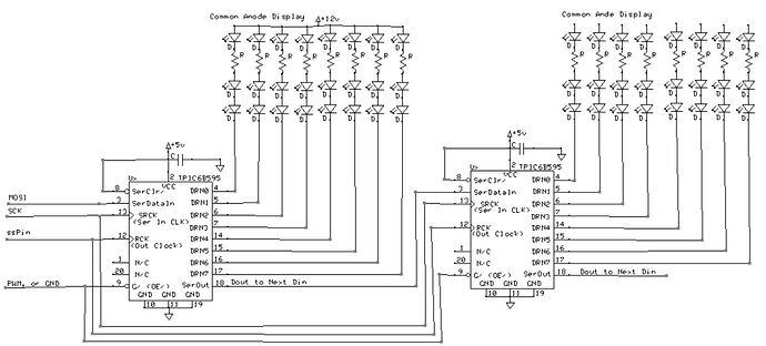

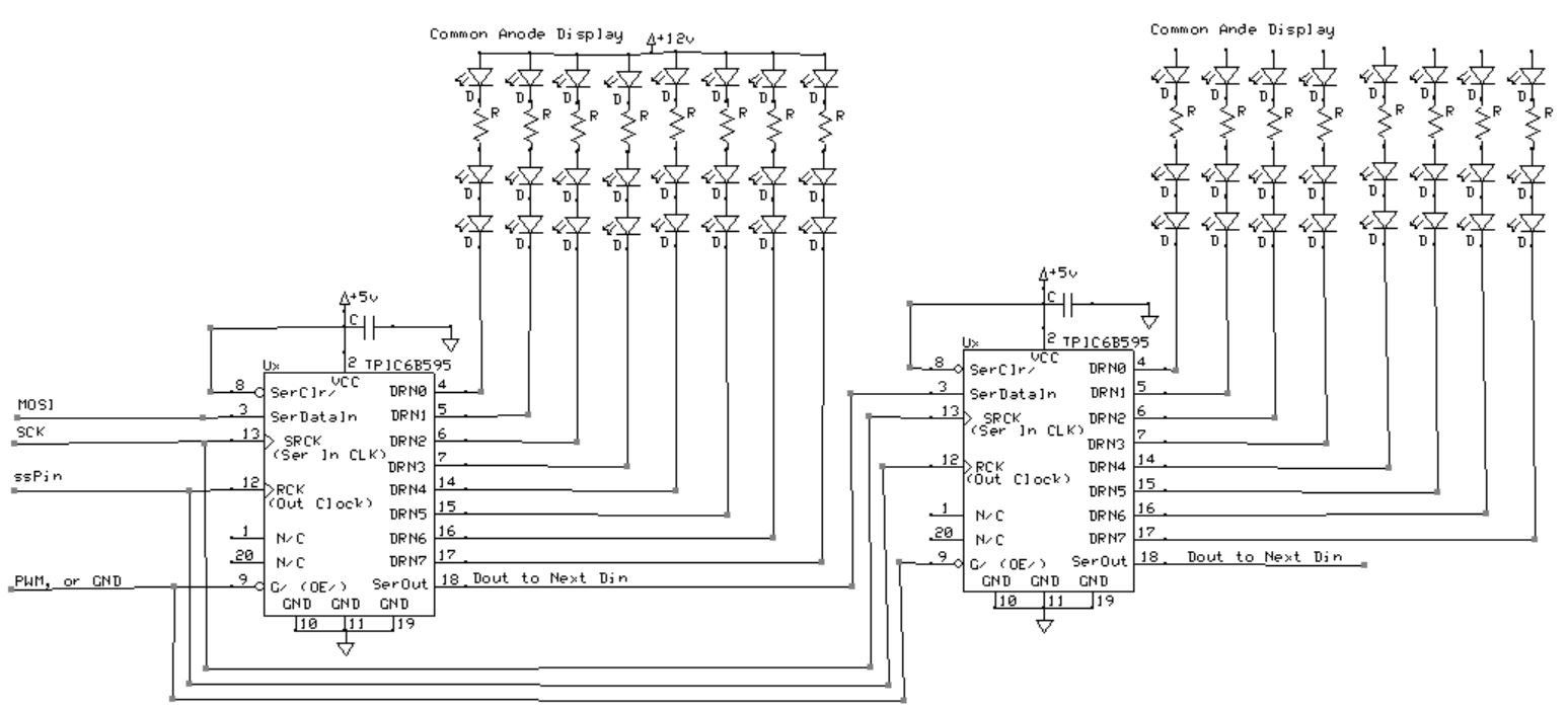

Instead, use TPIC6C595 or TPIC6B595. Each output goes to a series resistor/LED to the 24V. Shift in a 1, the output goes LOW, connected to an LED cathode to turn it on. Shift in a 0 to turn it off. No transistors needed.

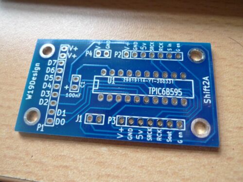

This is the board I use to make wiring up easy, but they are pretty easy to use on a verobaord.

Resistor value will be: (24V - (5 x Vf))/current desired = resistor value
So say Vf was 3.2V, and you want 10mA of current.
Then (24V - (5 x 3.2V))/0.01A = 800 ohm

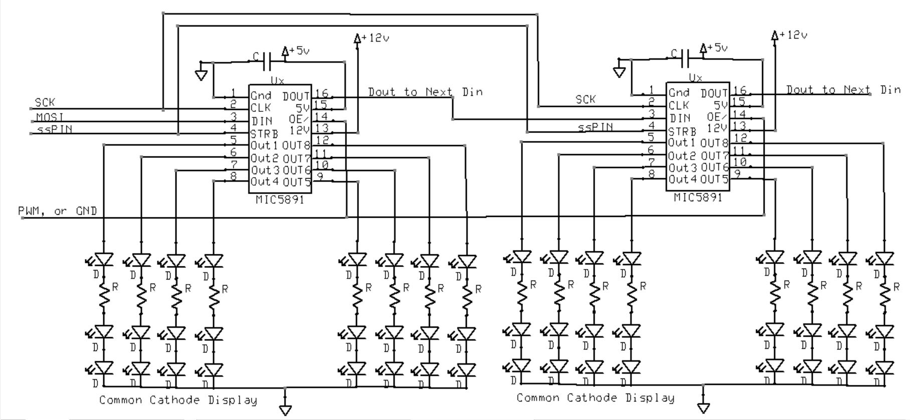

TPIC6B595 has current Sink outputs. If you want current Source outputs, then use MIC5891.
Individual transistors is a lot more effort, especially if you have an Arduino controlling things.
These schematics show 12V vs 24, both chips will work at 24V. And 5 LED vs 3 LEDs as long as the correct resistor is used.

If you want to go the NPN route, then connect the LEDs the same as the TPIC6B595.
