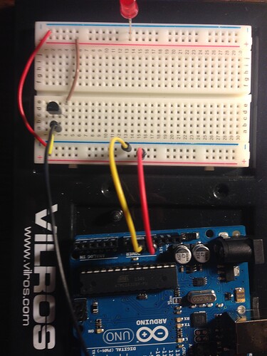

I have a project where I want to be able to completely power down some accessories when not in use (e.g. SD card, camera module).. My thought was to use a transistor to be able to switch power on and off. I'm using a breadboard, so I wanted to control power to one side of the breadboard for things I wanted switch on/off.
I hooked up a 2N2222 transistor and a simple LED as a test; I can successfully blink the LED. Everything seems fine, I can connect accessories to the +/- rails on the switched side of the breadboard and I see that they get power.
However, my accessories fail to work properly when behind the switched power (even if always on); move the power cables to the unswitched side, they work fine.
I connected my multimeter to the pins on the LED, and I am only showing 3.4 volts; checking power one the other side of the breadboard I get 5v. Does the transistor cause that much of a voltage drop, or am I doing something else wrong?

I don't see a base resistor nor do I see a series LED resistor.
Duue to the size of the pictures it's hard to tell on my phone.
A schematic is better.

The image loaded! You have 5v going to the collector then out to the emitter! Plenty of voltage loss.
Instead, you should either switch to a pnp or, on your npn...
emitter to ground
Collector to the negative terminal, eg - of your led.
  • of your led to the 5v rail
    Base pin to your button.
The transistor completes the path from the positive terminal of say your led through the collector to the emitter to gnd.
But!
You NEED a resistor (s) on the base and maybe between collector/emitter depending.
Please resample your images to a reasonable size, and post a schematic.
Lack of a base resistor is causing a reduction in voltage output because you are drawing a damaging ammount of current from the arduino pin.
When you switch the power to a deceive you must first remove any output signal you feed to it before the power is removed to prevent latch up.
You need a PNP transistor to do high-side switching, not an NPN transistor.
Without a base resistor something will be damaged. Use 220 ohms to get maximum
switched current.
For a switching transistor the load is on the collector, not the emitter, so the
device can work in the switching region (full saturation). The voltage drop across
the transistor should be 0.2V or less in full saturation.
