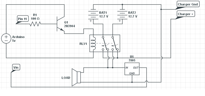

Hey All,
I feel like a mooch to be asking, but can anyone vett my schematic and tell me if I’m about to fry anything?
It’s meant to switch two 12v batteries between getting trickle charged by a PMW solar charger and running a load (and powering the Arduino itself.) A 5v DPDT relay makes the switch, which is triggered by a digital out through a 2n3904 transistor.
Will I need a capacitor to keep the Arduino going during the switch? Should there be diodes for any kind of hiccup when that happens?

Perhaps you could connect the batteries together so that they are feeding in parallel during the change-over. There used to be make-before-break switchgear for this purpose, but I guess simple relays are a better solution these days.
Thanks for the suggestion!
I’m having trouble working out how to wire the batteries in parallel so that they’re not always bypassing the relay or without resorting to a second switch (should note that I don’t know much of anything about circuits.)
I went the capacitor route, though I don’t know if it’s much of an improvement (ignore the farad value.)

ViolentValence:
Yes. The value will depend on how fast the switchover is.
No, but you DO need a diode across your relay coil, to kill the back EMF when you disconnect it. Otherwise the back EMF could fry your Arduino.

Henry, I added the diode to the coil--if you have any suggestions on how to minimize losses, I'd appreciate them.
You have to add a diode (3A one) and a large enough capacitor (ie. 2200uF/25V or even bigger) in there (see below), otherwise you risk the arduino may crash during the switch-over of the batteries… :wink:
The adding only the capacitor may not help you much as the capacitor may discharge itself through the “load” fast. So the diode will isolate the capacitor from discharging into the “load” and the capacitor will power the arduino for a while, hopefully :slight_smile:
You may consider to connect the 7805 reg to the batteries permanently via 2 diodes, so the switch-over of the batteries will not crash the arduino. I would add a simple filter into the arduino’s power rail as the switching between the batteries with different voltages may cause pulses.
The 7805 requires two 100nF decoupling capacitors connected as close as possible to its pins.
BTW the recommended input voltage for arduino (when powered from the external power source) is 7V. How do you plan to connect the arduino to the “7805” in your schematics above? Do you want to connect the 5V from the 7805 to internal 5V rail (not to recommend…)?
Or, safer imho, would be to use a 7808 and feed the power into the standard arduino external source input (the barrel jack).
Or to use other voltage regulator which gives you 7V external power for arduino (for example a low-dropout one based on how minimal voltage the batteries can provide worst case).
Or, another variant is to feed arduino directly from the filter, into its standard external power input. I would prefer a pre-regulation with a 7V output fed into arduino’s external power input (double stabilization), when you plan the system for the upcoming Mars expedition… :slight_smile:

Hey Pito, sorry to be late responding--your fault for giving so many great options!
I'm probably going to go with the simpler one-diode-blocking-the-load route (your first suggestion), and switch to a 5808 (I should have looked up the Ar's operating voltage before assuming 5v) and feed it into the barrel jack (already loped off an old adaptor.) Will I still need the decoupling capacitors this way?
Haven't made any plans for Mars, but this will be inside an aquaponics system floating on something equally inhospitable to life: chlorinated pool water. :slight_smile:
Yes, you always need decoupling capacitors with 7808 voltage regulator, placed as close as possible to its pins.
