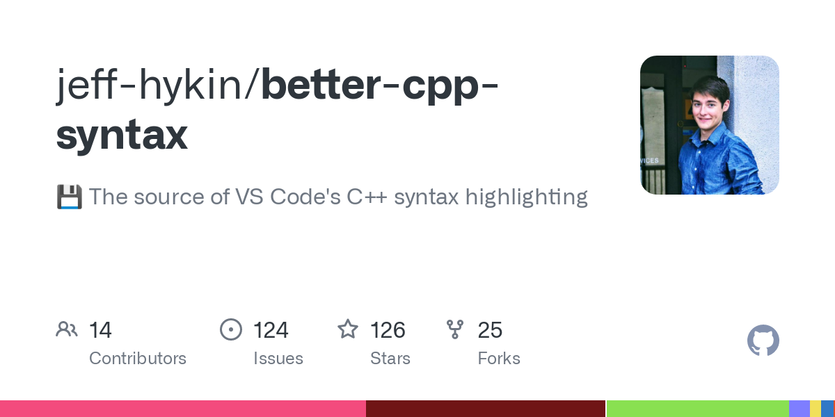

Would the VS Code documentation be a good place to look for the current settings? I'm a little unclear on how it treats structs and a couple of other things.
I would start by looking around in the repository of the syntax highlighting system:
Awesome, thank you!!!
