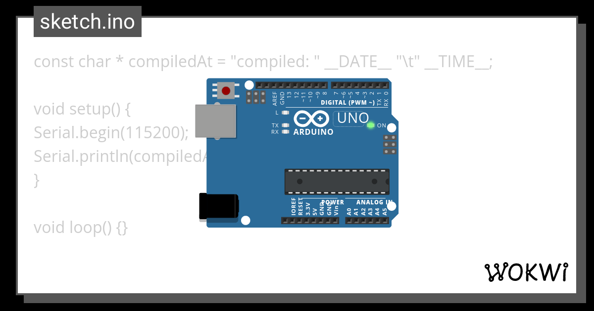

something like this may be?
const char * compiledOn = "compiled: " __DATE__ "\t" __TIME__;
  Serial.println(compiledOn);
void loop() {}
