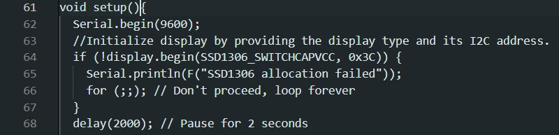

I've copied the code from the opening post in Car dashboard SSD1306 read & display speed sensor and did paste it in the IDE (initially 2.3.6, later 2.3.7 nightly build 20251025).
It was first noticed that void setup() was not highlighted.
This can be solved by applying an autoformat.
The next observation was that the PROGMEM table did not always colour correctly .
In line 33 and following lines the colouring is omitted. An autoformat sometimes mostly fixes this for most lines but not the two long lines (and the line following that). Undoing an autoformat does only partially restore the original syntax highlighting; it keeps the incorrect highlighting in 34 to 36 and often in other lines.
Note that the table issue (for me) is a lowest priority issue; it's just a tiny bit annoying when it's observed
Not highlighting setup() is a bigger issue as it can indicate a non-existing mistake.
Windows 11
IDE 2.3.6 and 2.3.7 nightly build 20251025
Tests done with a non-saved sketch and a saved sketch.
Hi @sterretje . I messed a bit with the sketch you list.
While doing something on the long lines (???) I got a message, something about highlighting stopped for performance reasons on long lines. I tried to get the message up again but could not manage that.
It did mention changing the “Editor: Max Tokenization Line Length ” (defaulted to 500 - the first long line is over 2200 long) to fix that. Tried and it does indeed fix it.
