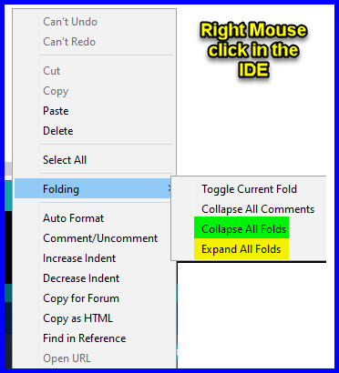

  • I often offer these three images to new users.
    ==^== is easily typed or copied into the Find: Text Box
  • Also, you can see the Find and Previous buttons.
Code Folding
