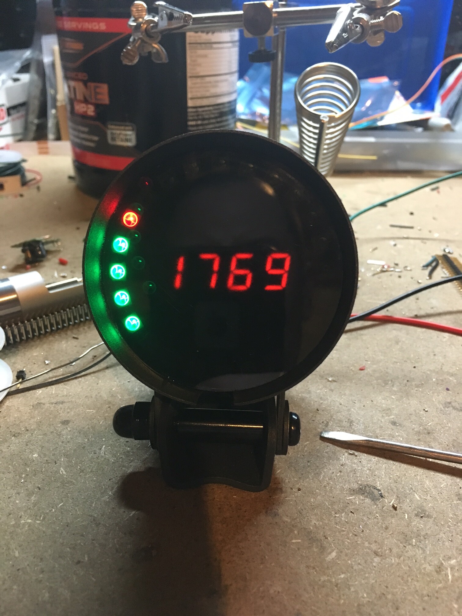

I've been working on a tachometer project with a friend of mine for some time now. It's using a Mini Pro 5v 16mhz, serial seven segment display and a 24 Neopixel ring.
I have an UNO that I'm using to simulate the PWM signal into the tachometer input pin of the Mini. Using this method the tachometer works flawlessly. It's nice and smooth when I turn the pot to increase the frequency.
On the vehicle I'm using the negative side of the ignition coil, piped into a Schmitt trigger. I also have a resistor, a capacitor, and a couple of diodes between that signal and the input of the optocoupler.
This issue I'm having is when the tach is connected to the negative side of the coil for the signal, the tach never stays as at a steady RPM, It pretty much just jumps all over the place. Yet when I go back to the frequency simulator, it's always nice and smooth. Is there a typical way of doing this if the negative side of the ignition coil is used at the tach signal?

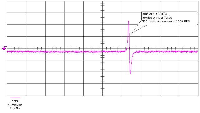

If the ignition signal looks like this, then the negative impulse will break the 6V reverse barrier of the opto diode and most likely create an extra impulse. I suggest adding a reverse connected diode to prevent this. Also a 10nF capacitor might be beneficial to smooth the signal just a little and ensure the schmitt trigger creates only 1 output pulse per input pulse.

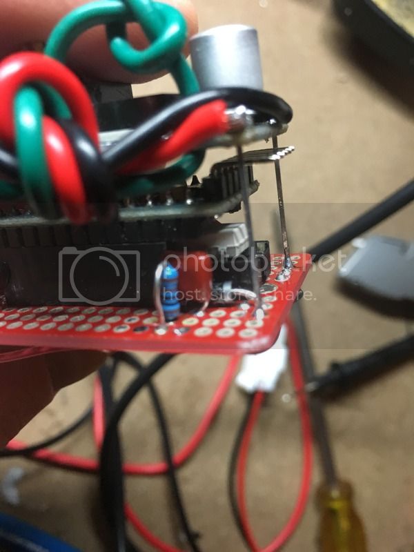

Look at my first post and the pictures attached. In 1.jpg you'll see I have a resistor, capacitor, diode arrangement similar to what you've illustrated. I do not have a ferrite core however as you've suggested.

This is what your opto is looking at, not just 12V but a massive >300V spike.
You will have to clamp the signal from the neg side of the coil so it only produces clean pulses.
The signal on the primary side comprises of.
  • electronic points open
  • spark
  • spark stops (>300V spike)
  • ringing (coil dissipating energy)
  • electronic points close
  • electronic points go into current limit mode
Tom.... :slight_smile:
Ahh, it wasn't on your hand drawn circuit. Anyways, if the signal is as TomGeorge has illustrated, it would be rather difficult to signal condition (but not impossible). Yes, a ferrite core will definitely help with any ground noise issues.
