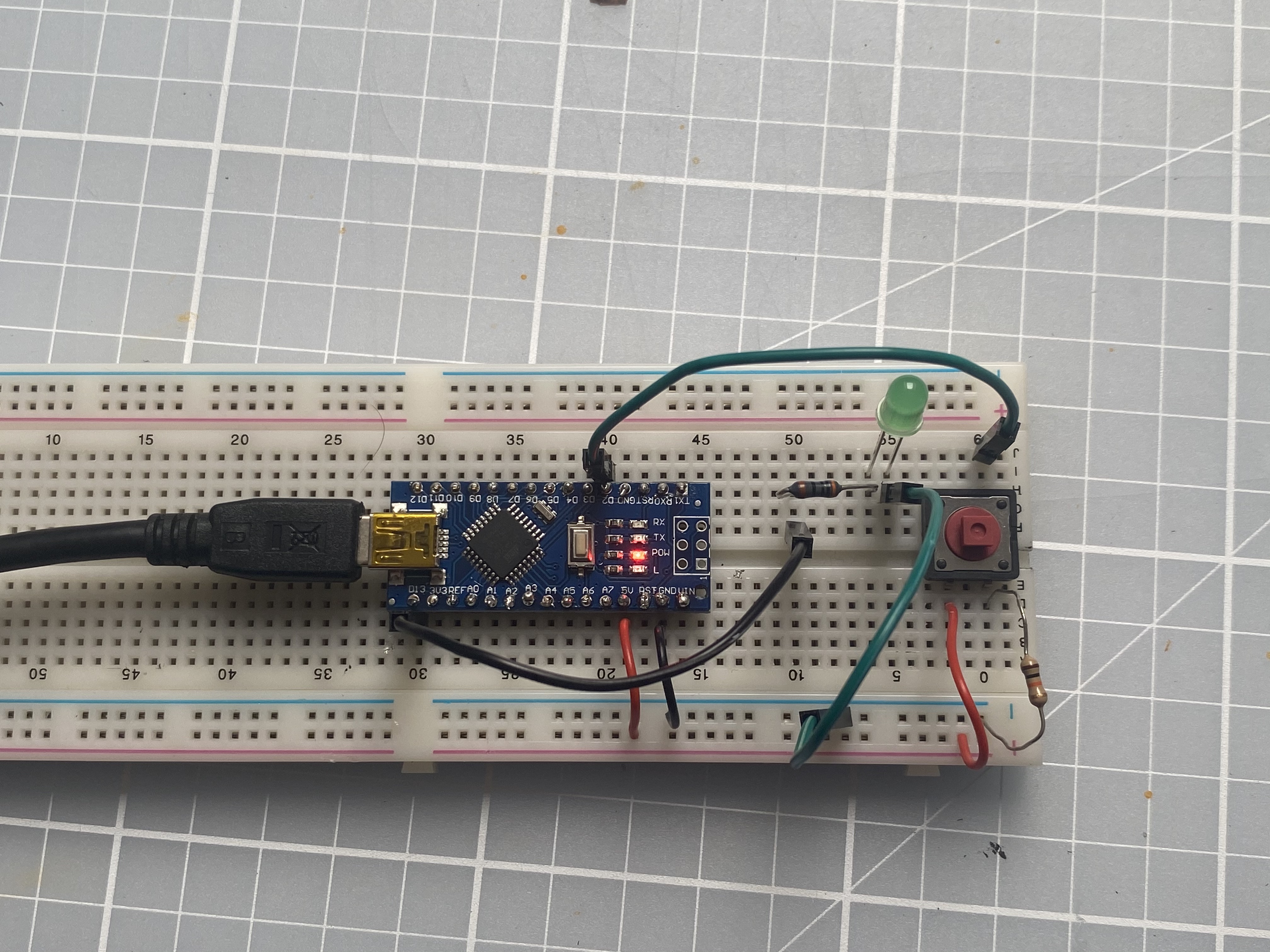

I'm very new to arduino and I'm trying to build a simple tactile button and LED circuit using a NANO.
I can get the circuit to light the LED without a switch, however, when I put the switch into the circuit and use the arduino button code, I can't seem to get the button to work.
Any help would massively be appreciated.

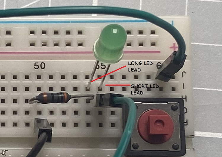

The code and circuit seem OK. Is the LED in backwards? Maybe try moving everything to a new breadboard, some breadboards have faulty pins.
This may help with your tactile button wiring.
buttonlegsdiag
Thanks for the quick reply. I think the LED is in the right way as it turns on without the switch in the circuit. I will try another breadboard now!
Thanks
Lew
Hi Tom,
Thanks for your help! I've just checked, i've got the LED legs in the right way around, however still no luck...
I think my switch is connected correctly?
Thanks

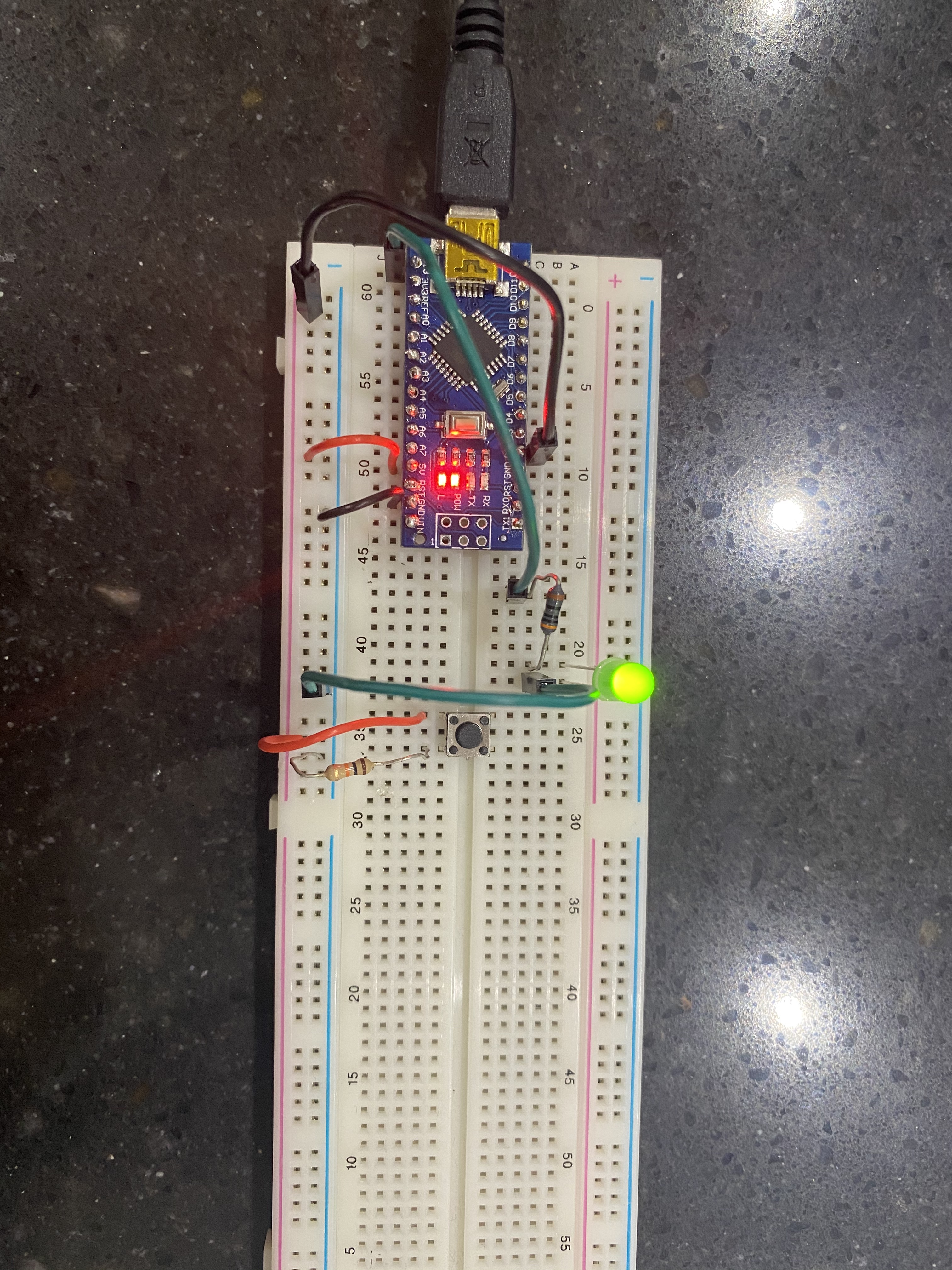

Post a picture of your protoboard with the change you have made, please.
Hi Tom,
Sure, please find attached below. It seems to be working great!!!
Lew
:grinning: :grinning:
How do you mean that config works with your button, the button isn't even connected to the NANO?
You may need to apply a bit more heat to those solder joints on the header pins on the NANO.
I'm not sure. But when the wire is connected from Pin 2 to the 5v rail. the switch is working?
Lew :slight_smile:
The switch ISN'T working? I thought you said it was. Did you try the switch again?

The switch is working, however, I was just unsure why as pin 2 is now connected to the 5V instead.
Cheers
