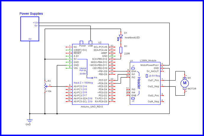

Take 2, DC motor control
Not very knowledgeable with this stuff, be kind please. :grin:
I have a DC window motor, L298N H bridge motor control board, an UNO, a volume knob thing (potentiometer), power, and a dream...
I would like to turn the knob and have the motor increase speed as I turn the knob in one direction. I would like the motor to return to 0 rpm as I turn the knob back the other way.
Could I get assistance with (everything) the code and wiring?
Thanks!
Jim
Always show us a good schematic of your proposed circuit.

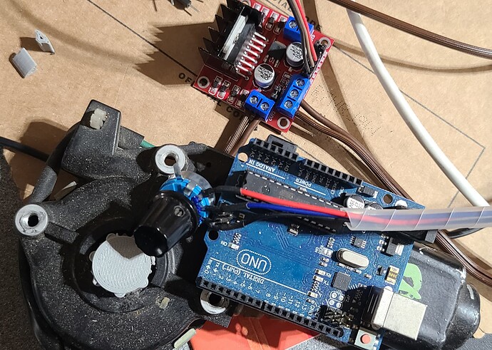

Show us a good image of your ‘actual’ wiring.
At the moment, I have none.
I've tried using various software to set it up but none have the L298N board.
Do you need to reverse the motor’s rotation ?
Yes but I planned to use a single throw double pole switch to flip the polarity. Ideally the pot would be at zero half way thru its stroke and turning the knob keft or right would result in fwd/back on the motor. But that is way above my level fer sure.

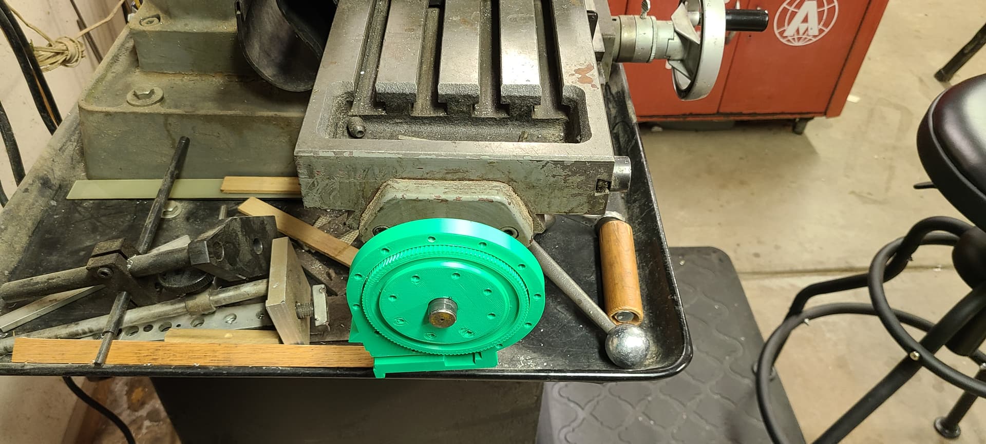

I was going to use a stepper motor fitted to a worm driven slew gear. I couldn't figure it out and didnt get the help I needed on this forum (too high level). So, applying the kiss principle, backing up to simple dc motor etc.

Why are there wires on the motor driver already ?
Ultimate goal is to power feed a mill table back and forth. 2 pics.
Are you sure the that motor can turn the controls ?

Wires are there from my failed solo attempts.
The motor has pos/neg leads, the pot has 3 wires, otherwise consider there to be no wires.
Won't know if it'll work til I try. From there, I can 3d print various gearing to get me over the hump.
Including reintroducing the slew gear setup.

How will you be powering the Arduino ?
Shorted leads no bueno. Apparently those leqds were bad. Switched leads. Shorted together 0.3 ohms. Connect to motor, 0.8 ohms. Using Fluke 77.
I have a 5v power source for UNO and a 12v separate source for the motor.
Switched meters to Cen-tech. Shorted = 0, motor =0 too.

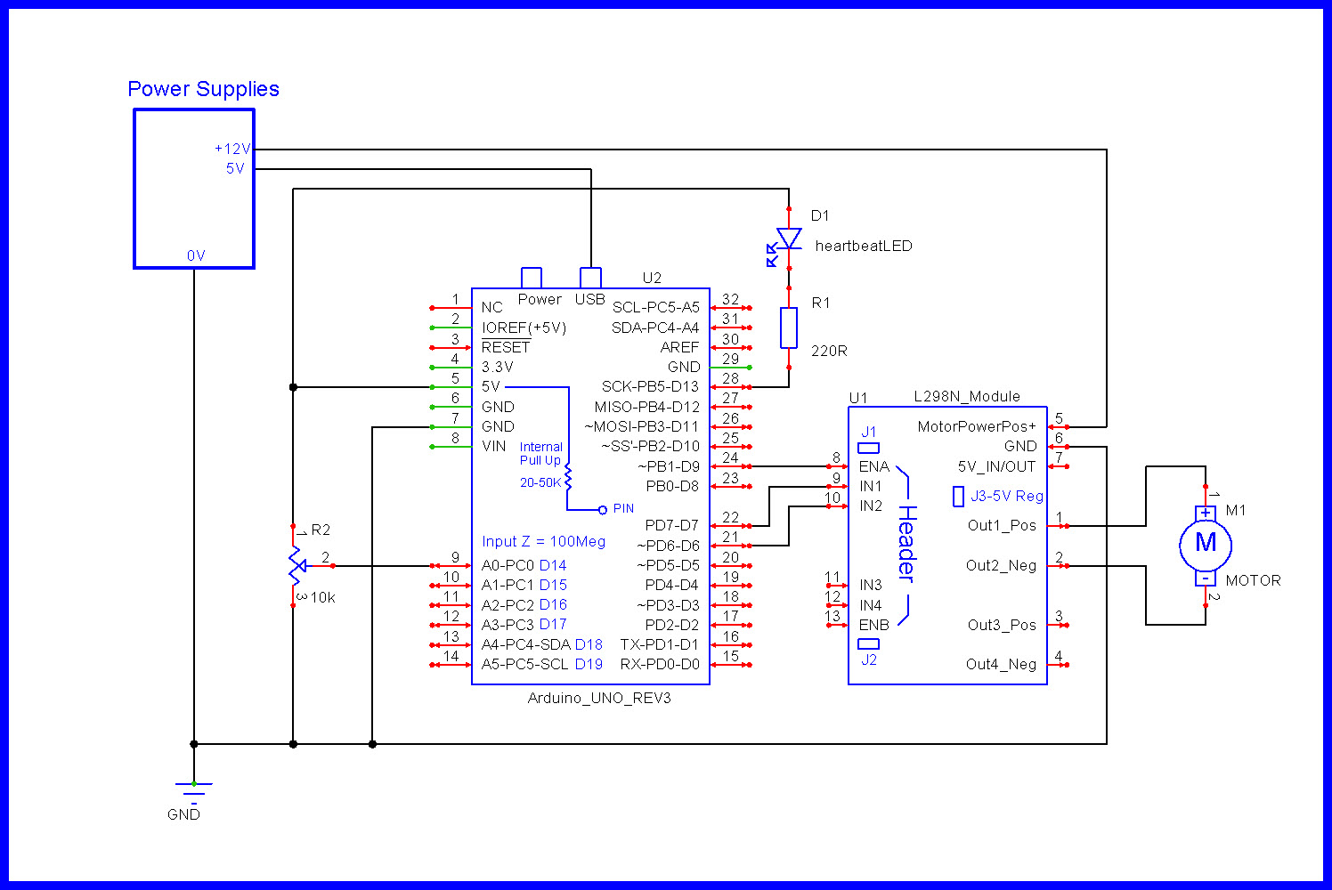

Does this schematic make sense to you ?
