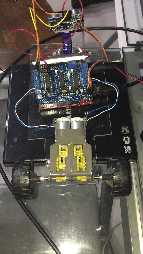

Im working on an obstacle avoiding robot from a sketch I got off a website.

The code seems fine, I've made one modification based on suggestions I got in these forums about commenting a few lines in the loop() because they werent really being used in the code.
What I would like to know is what is the best way to debug a sketch like this since so many things happen so fast repeatedly. Im used to adding serial prints but in this case they dont work well. From the video of the rig operating you can see the left engine works better than the right engine which seems to stop and sputter at times. Im guessing that is a gearbox issue.
But it also seems the logic is not working as intended since there is nothing in front of the sensor during the run and at times the motors run backwards. At least the left one seems to.
Here is the link to the video:
Imgur
Marciokoko:
One thing to do is to isolate the particular aspect of the program you're testing.
If you're testing how the motors run, set the motors to run at a set speed and delete the rest of the code. As the code is currently written it's hard to know why the motors are behaving as they are.
Reduce the number of variables you're testing to as few as possible.
There are certainly other things to help with debugging the above would be a good start.
What are you using as a power supply to the motor?
For testing I'm using the USB plug. I do have a lipo battery pack for the motor shield and a 9v battery for the Arduino for running it autonomously.
Ok I tried 2 things:
  1. I just made the motors run forward by calling only the moveForward() function. This made the motors run fine, continuously. It works fine even with my LiPo battery pack powering the shield and the 9V powering the arduino.
  2. I gutted the moving around code and just left this code:

I got this in the monitor. It seems fine. It reads the ping then checks forward. :
Checking path...
Checking forward... // these are called from setup
Reading ping... //probably from the setup() call of checkPath()
54
curDist > maxDist, maxDist has been set!
Checking forward...
Reading ping...
55

Here isa sorta decision tree I made...btw, is there a software to model this kinda thing?
Basically on every loop, it makes the map. I made a sample map as represented by a black rectangle as the robot, red rectangles as close obstacles (because the sketch calls for <10 objects and <20 objects) and yellow rectangles as far away objects.
Im confused because it seems that when it does find that curDist < COLL_DIST (when it finds a <10 close obstacle (red rectangle), the robot turnsLeft and then veersRight???
It doesnt make sense on 2 levels:
  1. Why if the object is on the left @8, why does it turn left?
  2. Why does it then veer right?
bump :slight_smile:
The latest code is in reply #3?
I'm a sucker for trying other people's code if I have the same sort of hardware, but I don't don't have the same setup as you and the code is more complex than I'd like to inspect for the fun of it.
Maybe someone else will feel inclined to peruse your code.
if not, I suggest simplifying the code as much as possible. Can you get the robot to stop when there's an obstacle? Can you have the robot drive in a circle?
It looks like you have debug statements but do you have enough to find the problem? When I have a bug in my code, I keep adding debug statements until I can identify the exact location in code where something unexpected occurs.
Yes I understand. I will try to make it run and stop when it finds an obstacle or make it go around in a circle.
I guess I wanted to know if my excel diagram does what the code says and specifically why I think there would be an issue with the code.
The specific point is here:
For pos 144 and 126 there are no obstacles within 20cm (turn distance) or 10cm (collision distance). Then in C, it finds an obstacle at 8 cm, so it goes into the if block and calls checkCourse() which itself reverses, stops and calls setCourse(). At this point maxAngle is still 144, it's the angle with the farthest clearance. So when setCourse() is called, maxAngle is > 90 so it turnsLeft, but the obstacle WAS at the left. And since curDist is also < turn_distance, it then calls to veerRight!? This doesn't make sense to me. Am I interpreting this correctly?
Ok I commented out everything and just left the first if from the checkPath() method which checks to see if curDist in < Coll_dist.
It would run very slowly and stop even with the LiPo battery pack. So I tested with a voltmeter and discovered the terminals for ext power of the shield were getting about 5-6V, Im using a 3.7V battery with a 5V stepup booster. But the motors at the shield terminals were only getting about 0.2-0.5V intermittently of course.
I plugged the unit into the laptop usb and the terminals at the shield were getting about 3.5V but one motor gets 1.1V and the other gets 0.5V. It seems there is a difference between what one motor gets vs the other.
I guess I need to get a NiMH pack from somewhere.
