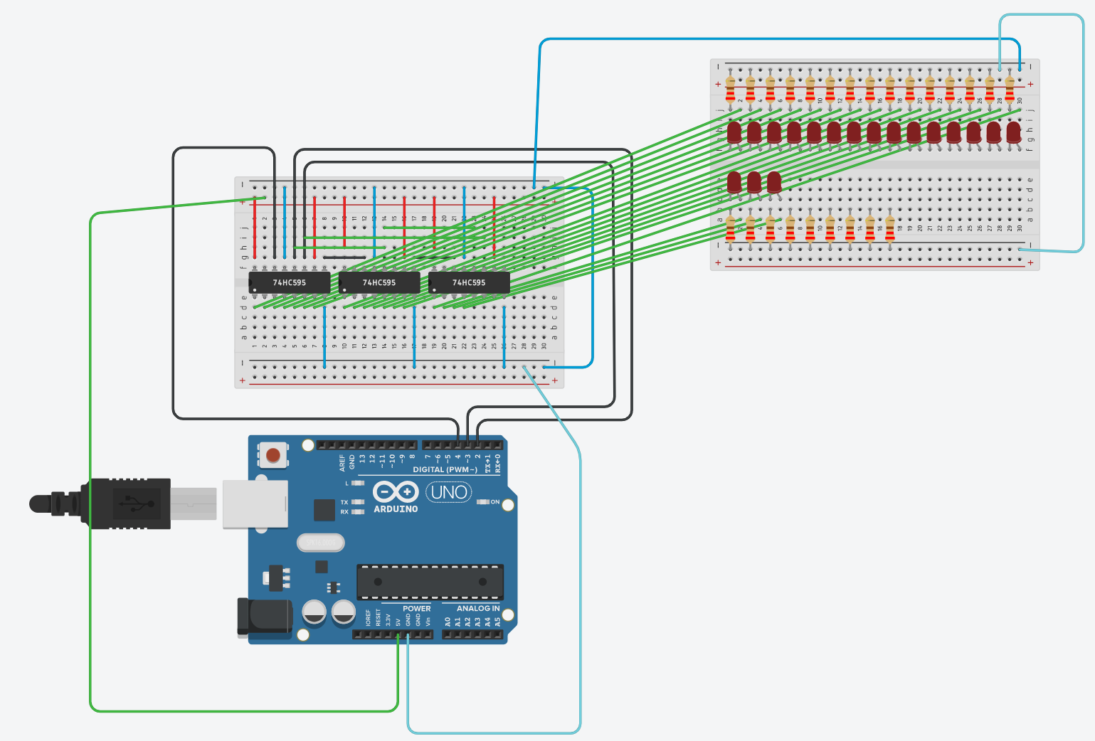

I have a project where I controle 18 LEDS with 3 74HC595 IC's.
When I upload my code and connect the LEDs to the Arduino uno & nano, everyting works fine.
But when I connect it to the Teensy 4.0 (the controller I want to use in my project) the LEDs don't do what they are expected too.
This is my code:

In this sipmle code, all the LEDs will turn on one by one till it reaches the end. Then they turn off one by one. This repeats itself.
This works perfectly when I connect it to an arduino uno & nano. But when connected to a Teensy 4.0 (with the same pin numbers) the LEDs follow a different pattern/ appear to be random.
Has anyone got a clue why the Teensy reacts this way, or what causes this issue?
In the attachment is a quick diagram of my circuit. I use a powersupply instead of the arduino / teensy power to give it enough Amps but I can't show this in the circuit diagram.
Set the Teensy CPU speed to 24Mhz and load the program again, same problem ?
Thanks! That did it. Apperantly 150 Mhz is also accepted. But above that it starts acting up again.
Thanks you so much!
There is a shoocker.
So your wiring is OK with a processor running at 16Mhz, but wont work when the proccessor is running at 600Mhz.
Look at the chapter "Timing Requirements" for the HC595 to see if you are within specification for the clock rates you are using on that Teensy 4.0.

WattsThat:
There is no point/need to slow the master clock of the Teensy down just to write to some shift registers.
There was a point, its a quick and easy diagnostic step ....................
Each 74hc595 should have a 0.1uF ceramic bypass cap. Also with 330R series resistors, you may be exceeding the maximum current of the '595, if only by a little (~77mA vs 70mA).
It might be better to use hardware SPI on the Teensy, then you can set that to run at a suitable speed for the '595s without slowing down the CPU.
