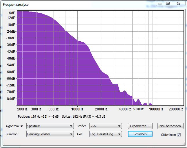

Here the analysis of BBb_Tuba_01 with 256FFTsize, 1024FFTsize and 65536FFTsize:
With 256 it`s impossible to detect the tone with the biggest amplitude.
And the second problem with FFT:
Other tones in the signal can be louder than the firs harmonic and then you can`t anymore search for the bin with the biggest amplitude.
