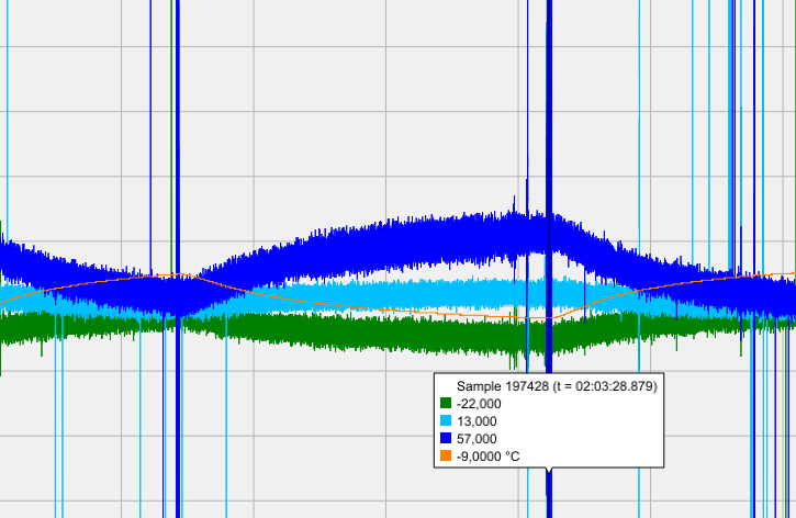

Moreover, my board is not oriented horizontally, as usual, but vertically - the Y axis points upward.
In the screenshots, the green line is the X-axis, the light blue line is the Y-axis, the blue line is the Z-axis, and the orange line is the temperature.
Temp.: +25
Temp.: -9
The Y-axis remains almost at the center(about zero), and the Z-axis goes up, and the X-axis goes down.
As the temperature decreases, not only the median part of the angular velocity shifts, but also the drift amplitude increases.
In general, the zero offset has two components - the initial zero offset and the zero drift. The physical cause of zero drift is a change in the size of the silicon elements and pressure inside the sensor case due to temperature changes
I can’t imagine how to compensate for this.

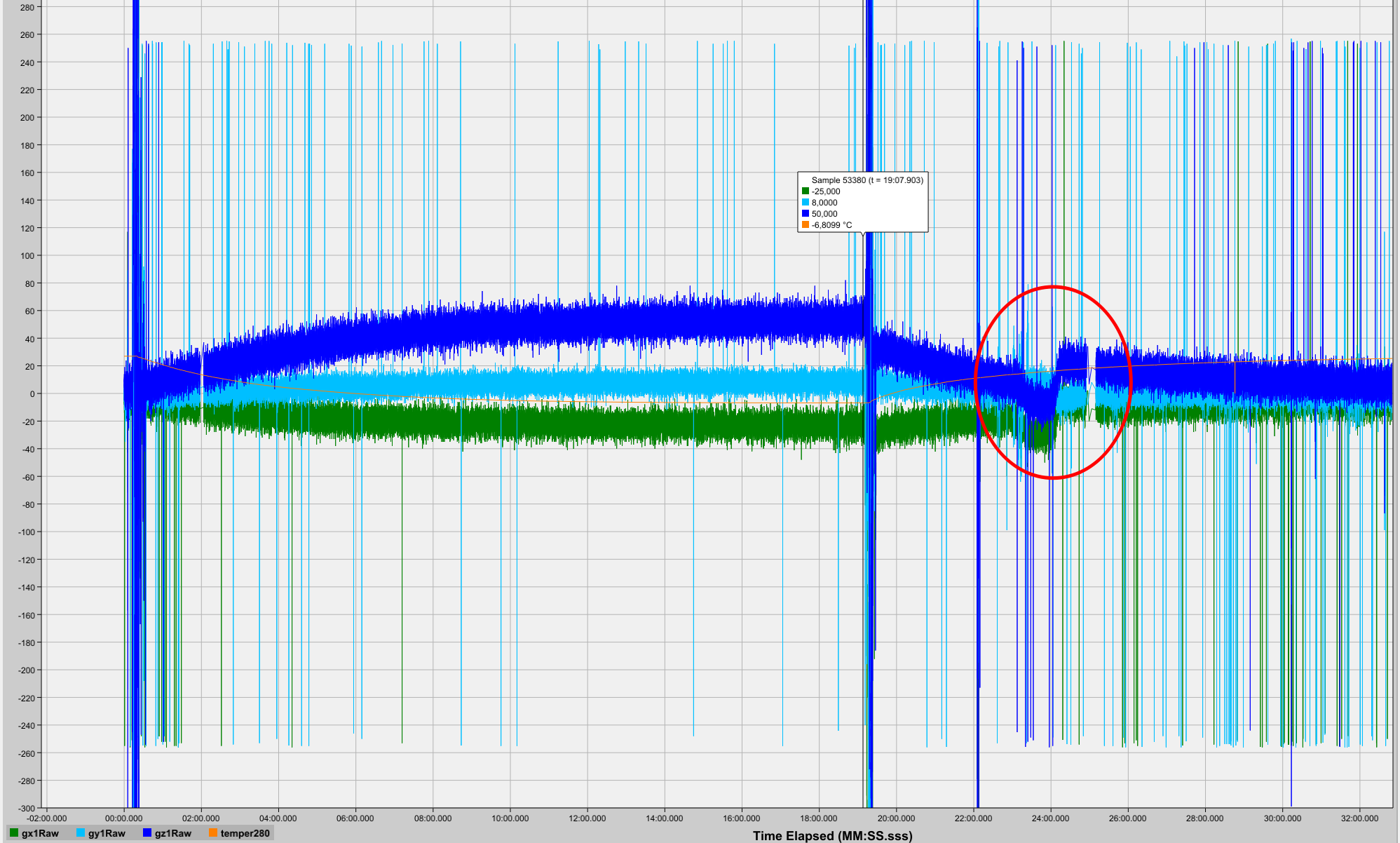

Everything started out fine, as the temperature dropped, the sensor slightly changed the initial offset (median component) and stayed there from +25 degrees to -13 degrees.
Miracles began when the sensor was placed from a cold environment into a room environment, the drift suddenly jumped upward, and all the axes seemed to go crazy.
Cooling is slower than heating, and due to the heating of the sensor from minus to room temperature, an avalanche-like drift occurred, which could only be established when the sensor temperature reached +23 ... +25
Moreover, I measured the temperature with a third-party BMP280 sensor, standing next to the LSM6DS3 gyroscope sensors, and I also get the temperature from the LSM6DS3 sensor itself.
But if at +24 degrees, the temperatures from the LSM6DS3 and BMP280 sensors are almost the same, then at 0 degrees, the difference becomes significant and the LSM6DS3 temperature sensor begins to critically lie with its readings.
Moreover, the temperature from the LSM6DS3 sensor drops much faster.
When heating occurs, the temperature from the LSM6DS3 sensor begins to rise much faster and is probably also the problem with such an “avalanche-like” drift of the angular velocity of the LSM6DS3 sensor.
So try to compensate for such an extraordinary drift, here interpolation won’t help, here you need to use Lagrange polynomials, the only thing I know about is the name.
The LSM6DS3 sensor was very surprising, because the manifestation of drift is not like other sensors; with this sensor, drift begins when heated.
If other sensors behave more or less the same during cooling and heating, then LSM6DS3 is simply the king of unpredictability!

Non-comensated drift

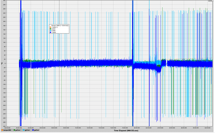

Here are the results of the correction function using the interpolation method.

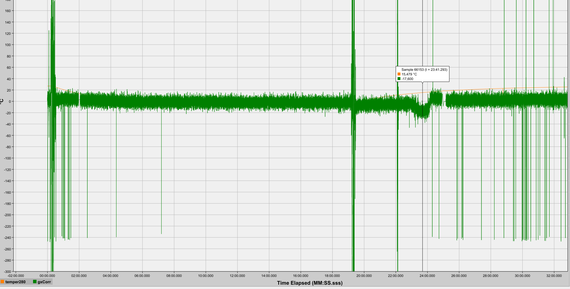

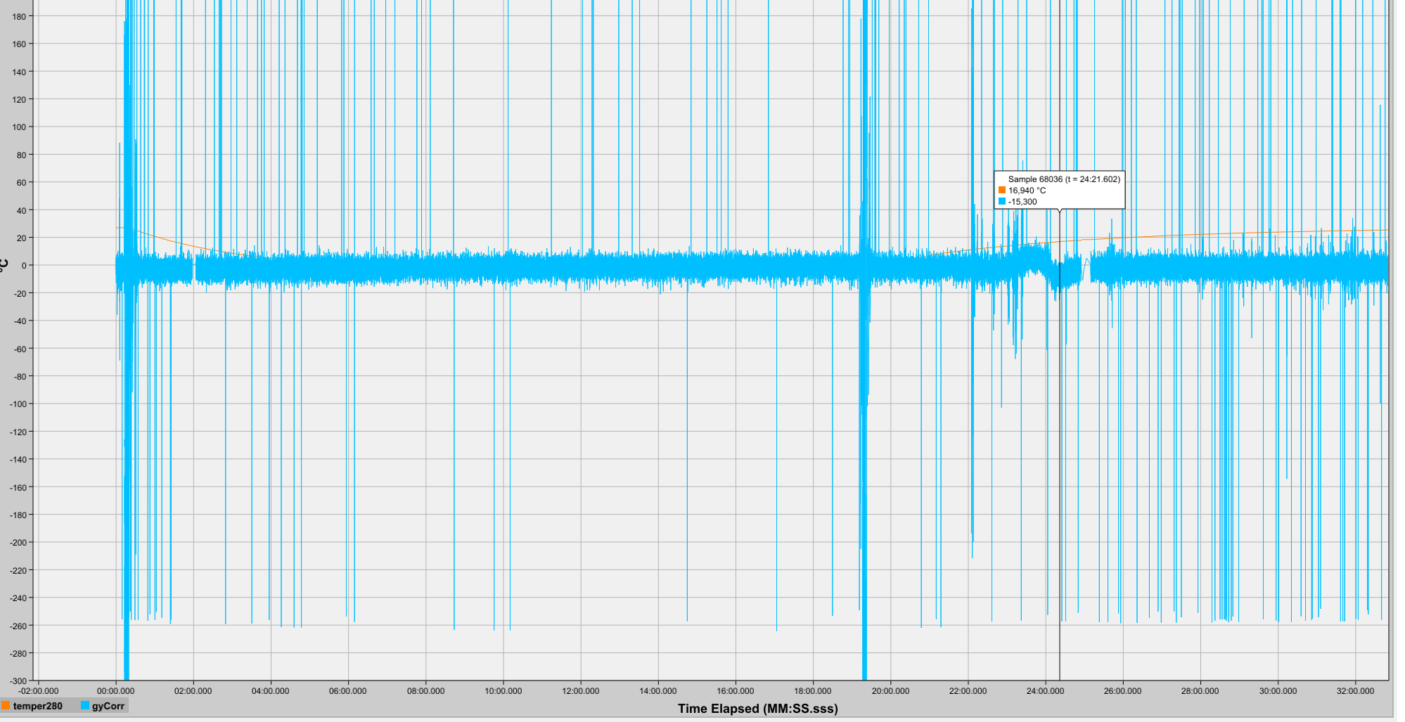

I separated the axes to make clear screenshots.
This is the simplest case of temperature drift of offset and zero.
Of course, the compensation function does its job, and the output angular velocities of the gyroscopes at rest are much stable and close to zero, while their linearity is observed, in contrast to the drifting angular velocity values.
But it also does not fully cope with some drift emissions, in the range from +6 to + 12 degrees when heated.
It’s as if it is necessary to introduce a second correction function for the temperature range from +14 to +18 as this temperature increases.
