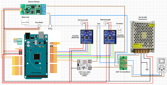

Brief update from my side. I have worked a bit on the circuit diagram and on the components that I will need.
To be able to control the speed of the pump I integrated a dimmer module that I can control with the Arduino. Ideally I can remove that later on an run the pump on a constant speed, this is just for testing purposes.
The Arduino itself will be powered by a 12V PSU.
Now to the tricky part, the control of the FTH. I selected a SSR Fotek-40DA 40A 480VAC / 32VDC which should be sufficient for the FTH that I mentioned in my first post.
I am looking into PWM and the coding of such. Does anyone have a good example of switch at zero crossing PWM?
I really appreciate any feedback regarding my circuit as I don't have the electrical background. Any missing components that one might spot?
Hi, @schlappo22
Be very careful using dimmers to control motors, you are controlling an inductive load and a lamp dimmer may not work for you.
In fact your pump from the link in post #1 is a vibration pump, not a motor type, that is it runs at the mains frequency, it is also an inductive load so the lamp dimmer will not function in this case.
As the FTH is resistive load your Lamp Dimmer would be more suitable if it is rated for the current, you don't need zero crossing detection as that would be done in the actual Dimmer.
Thanks for your reply @TomGeorge.
I see. How would you recommend to control the speed of a vibration pump instead?
Regarding the FTH, that is how the supplier recommends to do the control. "not controlled by phase cutting, the control only switches at zero-cross". I am in contact with them so hope to get a bit more information first hand.
Zero crossing switching will mean turning on for so many cycles and off for some many. The ratio of cycles being the duty cycle.
Each time ON at a zero cross and OFF at a zero cross, this reduces electrical noise.
It will be interesting what the FTH supplier suggests.
You will need to find a motor phase controller for the pump, the amplitude that the cycle gets turned ON at is reflected in the throw of the vibrator arm, an so the amount of liquid.
Again, this pump may not respond to such control.
That is about all I can say, not being particularly familiar with this hardware.
It means it only switches at the zeros. If you switch the input at places other than the zeros, the output won't switch. You get whole positive or negative phase-chunks, and the control switches them on or off at twice the line frequency, (or 120Hz for a 60Hz line).
ETA: Per the Arduino PID V1 library, consider the relay control example:
... and choose a control time /WindowSize the length of a number of half-cycles. Maybe on the order of WindowSize = 1000L*100/120; or WindowSize = 1000L*255/120;

I am looking into the PWM control at the moment and it doesn't seem to be too trivial. I think from a hardware perspective I am there with the SRR and the Zero Cross switching. However I struggle to find the right way forward from the software side of things.
So I want to control the FTH by only switching at zero crossings. And as there are different power-lines inside the heater, I will be able to generate different average powers over 10 phases.

The SSR likely handles switching at the zero crossings by itself--if you have the input on or off when the zero crossing happens, it will switch accordingly.
As for how to control it with a PID, consider the Arduino PID example for relay control in Temperature Control Flow Through Heater - #49 by DaveX

//Thermocouple Stuff

How wrong are they and at what temperatures? What is your NTC schematic? With an NTC, it's easy to make the schematic backwards from the voltage divider calculation.
Your couple-step voltage divider calc looks like it reduces to:
Rth = Rref /(1023.0/ADC -1)
which is reasonable for a schematic with the Rref between the ADC and ground, so the measured voltage goes up as the temperature goes up on the NTC Rth. Is that what your schematic is?
The difference is small, but I'm partial to this form:
Rth = Rref/(1024.0/((ADC+0.5) -1)
Why choose Rref = 12000?
With two independent measurements, it is difficult to know which one is more true without good calibration.
Knowing the actual resistances for the thermistor circuit is a big source of error in the calculation. Can you measure Rref, nominal_temperature and nominal_resistance and value? I'd think your nominal 50K Beta=3970 should measure around 3.4K at 100C. With the actual measured values, you should be able to calibrate the thermistor precisely to your thermocouple at room temperature and at operating temperature with a beta calculator, and then the two sensors should agree very well.
Thanks for your reply. I will have to make a few measurements today so that I can provide some data. But my schematics look as followed:
Rref was chosen to be 12000 as that was the recommended value from the FTH supplier. It should not make a difference as long as we know the value and get the calculation correct accordingly.

I performed a few trials now. At room temperature, all sensors read the same value (+-0.5degC). One Thermocouple I use to monitor the temperature on the FTH itself and the other one is held into the outgoing water stream (which explains why some readings don't come through, probably grounded?)
With the PID above, the temperature on the NTC raised from 25degC to 28degC. The Temperature on the FTH raised from 25degC to max. 69degC and the water temperature on the outlet side raised to 37degC. So I have a huge difference between the NTC (which is the Input value for the PID) and the actual output temperature.
Solved --> Water Inlet and Outlet were swapped, so the NTC was located on the inlet side.... rookie mistake :smiley:
However now I have played a bit with the PID. I get 70degC Water within roughly 1s. That is heating it up from 25degC. But the PID does not seem to do anything but to just open the "flood gates" meaning 100% of the time the SSR is open, regardless of the input value... I set Kd and Ki to 0 and started playing with the Kp, even at 0.1 I get 70degC even though I set 35 as a setpoint.
Even when all (Kp, Kd and Ki) are set to 0 the Relay is open the whole time. I am trying to understand the PID code at the moment where this might be coming from but unsure so far.
